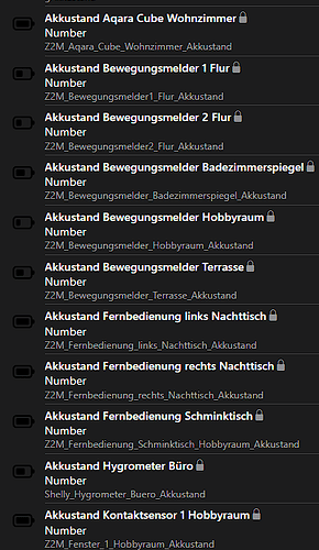

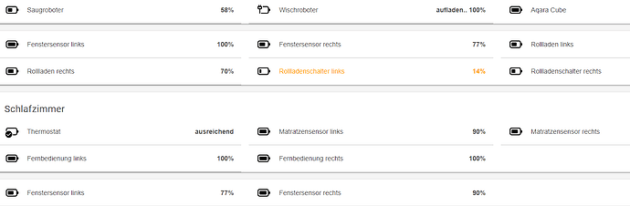

Version 3.9.0
I am only using custom icons. And as said, everywhere else it works fine, except on my device.

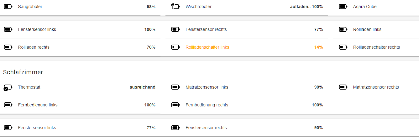

Text label="Ladestandsanzeigen" icon="newbattery-50" {
Frame label="Wohnzimmer" {
Text item=iRobot_Roombai7_MeisterProper_Akkustand label="Saugroboter" labelcolor=[<=10="red", <=20="orange", ON="red"] valuecolor=[<=10="red", <=20="orange", ON="red"] visibility=[iRobot_Roombai7_MeisterProper_Status != "charge"]
Text item=iRobot_Roombai7_MeisterProper_Akkustand label="Saugroboter [aufladen.. %d%%]" valuecolor=[<=99="green"] icon="newbattery-charge" visibility=[iRobot_Roombai7_MeisterProper_Status == "charge"]
Text item=iRobot_BraavaJetM6_CillitBang_Akkustand label="Wischroboter" labelcolor=[<=10="red", <=20="orange", ON="red"] valuecolor=[<=10="red", <=20="orange", ON="red"] visibility=[iRobot_BraavaJetM6_CillitBang_Status != "charge"]
Text item=iRobot_BraavaJetM6_CillitBang_Akkustand label="Wischroboter [aufladen.. %d%%]" valuecolor=[<=99="green"] icon="newbattery-charge" visibility=[iRobot_BraavaJetM6_CillitBang_Status == "charge"]
Text item=Z2M_Aqara_Cube_Wohnzimmer_Akkustand label="Aqara Cube" labelcolor=[<=10="red", <=20="orange", ON="red"] valuecolor=[<=10="red", <=20="orange", ON="red"]
Frame {
Text item=Z2M_Fenster_links_Wohnzimmer_Akkustand label="Fenstersensor links" labelcolor=[<=10="red", <=20="orange", ON="red"] valuecolor=[<=10="red", <=20="orange", ON="red"]
Text item=Z2M_Fenster_rechts_Wohnzimmer_Akkustand label="Fenstersensor rechts" labelcolor=[<=10="red", <=20="orange", ON="red"] valuecolor=[<=10="red", <=20="orange", ON="red"]
Text item=Z2M_Rollladen_links_Wohnzimmer_Akkustand label="Rollladen links" labelcolor=[<=10="red", <=20="orange", ON="red"] valuecolor=[<=10="red", <=20="orange", ON="red"]
Text item=Z2M_Rollladen_rechts_Wohnzimmer_Akkustand label="Rollladen rechts" labelcolor=[<=10="red", <=20="orange", ON="red"] valuecolor=[<=10="red", <=20="orange", ON="red"]
Text item=Z2M_Rollladenschalter_links_Wohnzimmer_Akkustand label="Rollladenschalter links" labelcolor=[<=10="red", <=20="orange", ON="red"] valuecolor=[<=10="red", <=20="orange", ON="red"]
Text item=Z2M_Rollladenschalter_rechts_Wohnzimmer_Akkustand label="Rollladenschalter rechts" labelcolor=[<=10="red", <=20="orange", ON="red"] valuecolor=[<=10="red", <=20="orange", ON="red"]
Frame label="Schlafzimmer" {
Text item=Tado_Akkustand_Schlafzimmer label="Thermostat" labelcolor=[<=10="red", <=20="orange", ON="red"] valuecolor=[<=10="red", <=20="orange", ON="red"]
Text item=Z2M_MatratzensensorLinks_Schlafzimmer_Akkustand label="Matratzensensor links" labelcolor=[<=10="red", <=20="orange", ON="red"] valuecolor=[<=10="red", <=20="orange", ON="red"]
Text item=Z2M_MatratzensensorRechts_Schlafzimmer_Akkustand label="Matratzensensor rechts" labelcolor=[<=10="red", <=20="orange", ON="red"] valuecolor=[<=10="red", <=20="orange", ON="red"]
Text item=Z2M_Fernbedienung_links_Nachttisch_Akkustand label="Fernbedienung links" labelcolor=[<=10="red", <=20="orange", ON="red"] valuecolor=[<=10="red", <=20="orange", ON="red"]
Text item=Z2M_Fernbedienung_rechts_Nachttisch_Akkustand label="Fernbedienung rechts" labelcolor=[<=10="red", <=20="orange", ON="red"] valuecolor=[<=10="red", <=20="orange", ON="red"]
