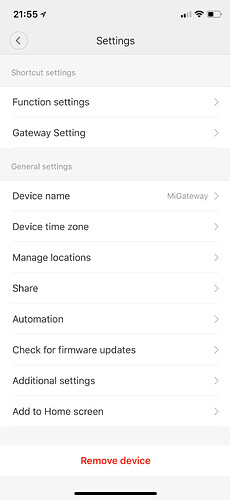

I’m trying to use the ‘Xiaomi Mi Smart Home Binding’ to control curtains. All works using the mi home app.
I’ve following the instructions about accessing the developer mode by going to ‘About’ but in the latest version of mi home on IOS, v4.7.18 it’s not there :frowning:
Any ideas?

Nope. That’s the same instructions I tried to follow originally, there is no ‘About’ option. Thanks tho.

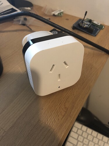

Not sure if it makes any difference I’m using the ‘Smart Gateway 3’ I’ve ordered a ‘2’ to see if it makes any difference.
Just received the ‘Gateway’ device, ie the round one with the light and it does have the Lan Control option. The other device I’ve got is the AC Partner v3 which can act as a gateway but doesn’t seem to have this option…

I just bought a Mi Control Hub (Gateway) and I am also not able to find the About section to activate the Dev Mode. How can you tell what version it is? It doesn’t show me any version numbers on the box, nor in the Mi Home Android App.
If you’ve got the same one in the photo above, that’s the same issue I had… it doesnt show you the about section. I never managed to enable dev mode.
You need to the round one.
