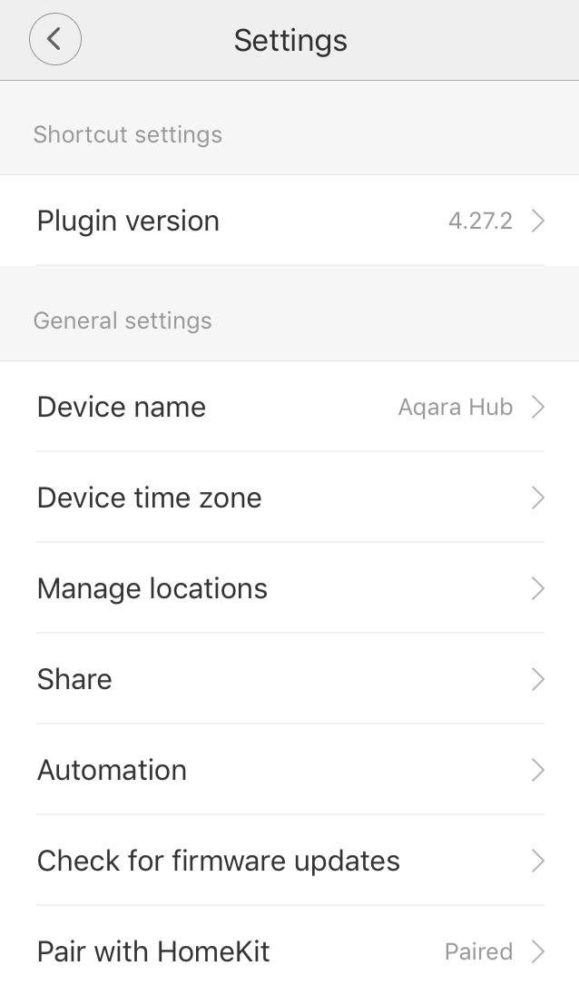

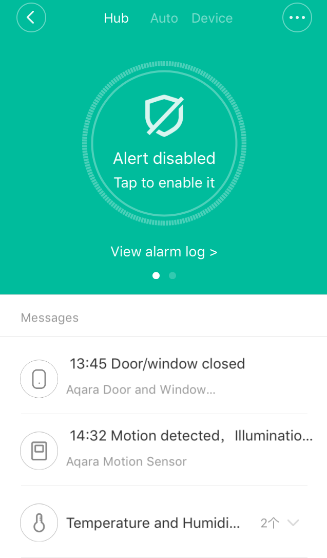

Same issue with the current XiamoiHome-iOS-App (V4.19.1)
When selecting the AqaraHUB, it looks like that:

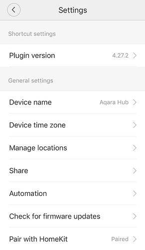

When I click on the three dots in the upper right corner, I don’t get “about” - it will show immediately the “Settings”-page like this:
Any ideas?
