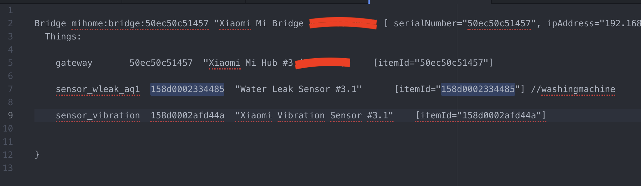

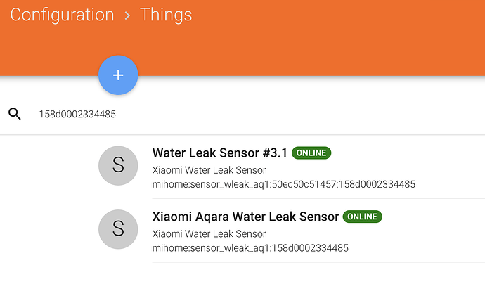

Here is an example of a waterleak sensor.
In the things file I gave it the name “Water Leak Sensor #3.1” and one of the things has this name, then there is the duplicate with the same ID 158d0002334485 with a generic name.

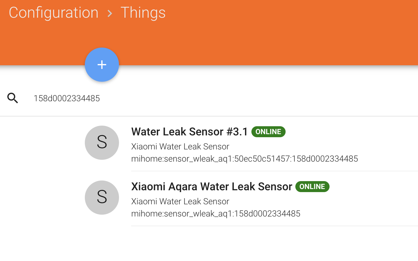

What I noticed is that the channel of those things differ.
The things I defined in my things file have the ID of the bridge included in the channel, you can also see it in the screenshot, the generic ones do not have the bridge ID in the channel:
mihome:sensor_wleak_aq1:50ec50c51457:158d0002334485
vs.
mihome:sensor_wleak_aq1:158d0002334485

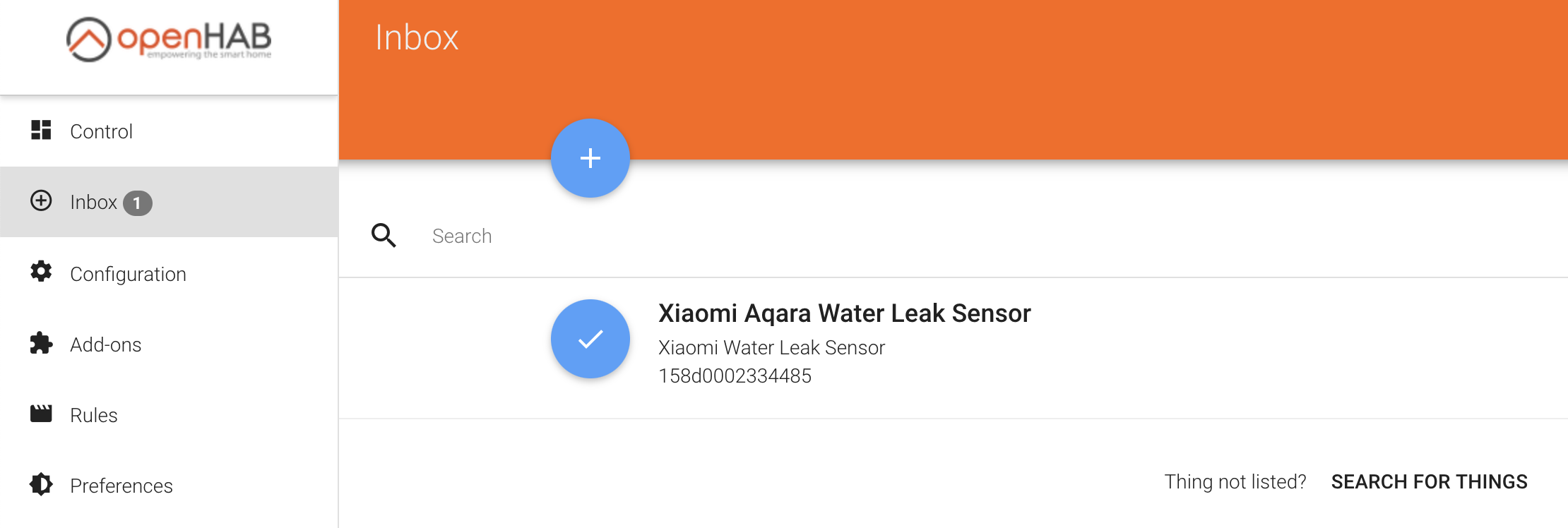

And another update, I just restarted the OpenHab2 server and the duplicate Water Leak Sensor appears again in the Inbox…
Simple Mode is OFF and the thing is already present in my things list…although with another channel as I mentioned.
