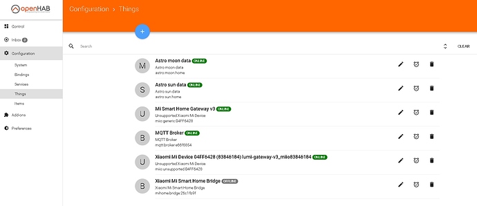

Issue of the topic: Xiaomi bridge staying Offline.
Please post configurations (if applicable): Installed the Xiaomi Smart Home Binding and managed to connect the device with the Xiaomi App and get the token and developer key. Since nothing apeard in my inbox i installed the bridge and gateway manually.
My problem is that when i auto search for it in OH nothing is found.![1|690x256]
This is from the log of OH:
2019-07-14 10:23:25.471 [WARN ] [core.thing.internal.ThingManagerImpl] - Disposing handler for thing ‘miio:unsupported:04FF6428’ takes more than 5000ms.
2019-07-14 10:23:25.489 [hingStatusInfoChangedEvent] - ‘miio:unsupported:04FF6428’ changed from UNINITIALIZED to UNINITIALIZED (HANDLER_MISSING_ERROR)
2019-07-14 12:47:35.627 [hingStatusInfoChangedEvent] - ‘mihome:bridge:26c1fb9f’ changed from INITIALIZING to OFFLINE

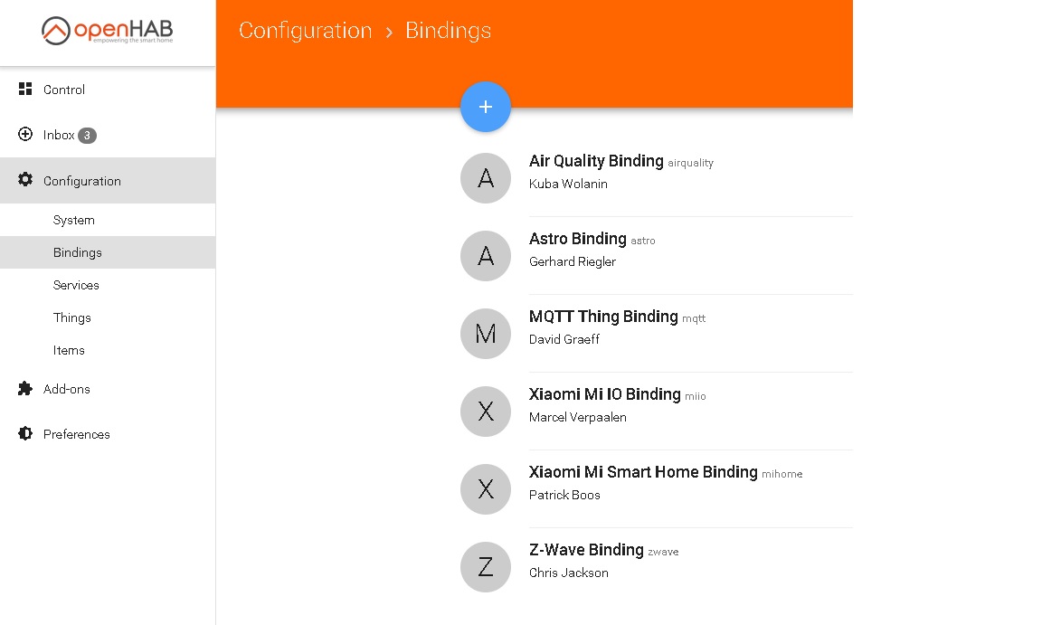

Hi @angelstoev
The first thing I’ve noticed is that the binding you are using seems to incorrect. Xiaomi MI Device… seems to be connected using Xiaomi Mi IO Binding. I suggest uinstalling that binding(if you are not using it fir something else). Remove both Xiaomi entries. Add MI Home Bridge using Xiaomi Mi Smart Home Binding. Your Gateway should now be added as a Thing to Xiaomi MI Smart Home Bridge. I hope it helps.
