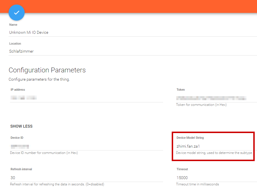

I have just bought a Xiaomi fan, device id is zhimi.fan.za4.
Is it possible to update the binding to include my fan
Hi @ahaghshenas,
Yes, can you please try to control it with the current binding.
Pls add your device manually as basic device. Than overwrite in the config the modelId with zhimi.fan.za1 That most likely will allow the control.
Pls feedback if that works.
That seems to work, not sure if it is 100%.

Hi Marcel,
could you explain what you mean with “Than overwrite in the config the modelId with zhimi.fan.za1”. Where do i have to overwrite the modelid and how?
Do you have already an updated jar file of your binding, which I could try?
Regards,
Riza
I mean, go into the thing configuration. There you can see the modelId…If communication is working, this would be auto populated with the model of your fan.
Overwrite this with the modelId zhimi.fan.za1 as than the binding will take that model’s commands/channels etc.
This way you can experiment with devices for which no definition exists yet by using similar models.
Many models share similar commands, with slight variations depending on the devices capabilities.
Marcel,
I did edit the device model string as shown in the picture:
However, it stays being unsupported:
No fan control channels are available. What am I doing wrong?
Normally that should work. You can try to add it as a basic device instead (manually), than it does not do the switching of thingtype in the background.
Make sure you remove the unsupported type as 2 things for the same device gives connectivity issues
That did the trick. I was trying to reconfigure the “found” thing, but I hat to create it from scratch. Thank you.
