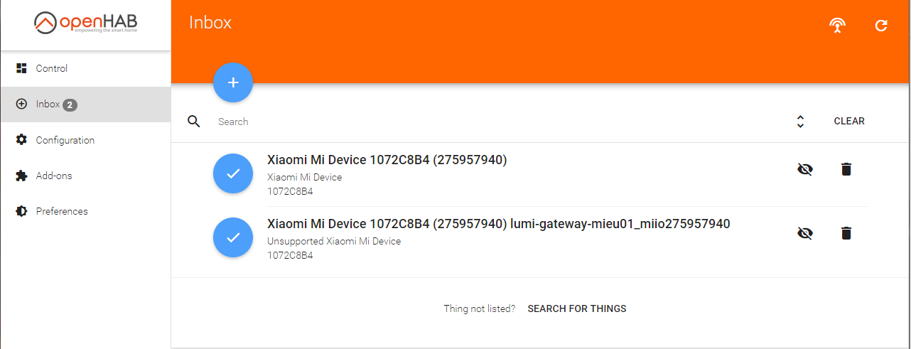

Hello! I’m very new to the OpenHab Eco-system, currently experimenting with it to see if it would be a great hub for my household. I just started to tinker with OpenHab2 last 2 weeks and currently my server is on a ubuntu Virtual Machine (Virtual Box) on a laptop which is directly connected to my dedicated router. The reason why I am using a laptop is because I’m still testing weather or not it’s worth it to transfer to an open source Hub rather than relying to cloud services.

I’ve updated all the devices on having the notion that it would function regardless of any update that the Xiaomi Home app had, it did matter. I’ve launched Paper UI and actually found my gateway but it appeared as an Unsupported Mi Device:

what version of openhab are you using? I just had a similar issue and I was advised that it’s a known bug and that was fixed in the latest version (2.5.5).
currently using the latest version 2.5.5
