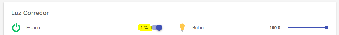

Xiaomi gateway switch to brightness strange behavior
In the basic UI the label appears always with a percent ‘%’
My Items
Switch iluminacaoCorredorEstado “Estado” {channel=“mihome:gateway:7811dcb9e925:brightness”}
Dimmer iluminacaoCorredorBrilho “Brilho [%.1f]” { channel=“mihome:gateway:7811dcb9e925:brightness” }`

other strange behavior when i switch OFF on basic UI then i can not tap only on o the native app because brightness is 0

To remove the percentage do this:
Switch iluminacaoCorredorEstado “Estado[]” {channel=“mihome:gateway:7811dcb9e925:brightness”}
You don’t need a decimal point for a dimmer percentage:
Dimmer iluminacaoCorredorBrilho “Brilho [%d]” { channel=“mihome:gateway:7811dcb9e925:brightness” }`

Many Thanks now no I have no percentage on label
I will try to explain better the second part
If I switch off the lights on openhab when I back to xiaomi app and tap to switch on the light, their don’t light because the brightness is zero as can be seen on the picture
