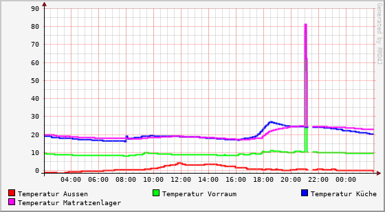

Using the Xiaomi binding, with v3 of the gateway and those rectangular temperature/humidity,/pressure sensors.
From time to time I get these glitches:
The batteries are newly replaced. Is there something I can do to avoid those?
It’s the peak of 100°C, not the little pause later caused by internet outage.

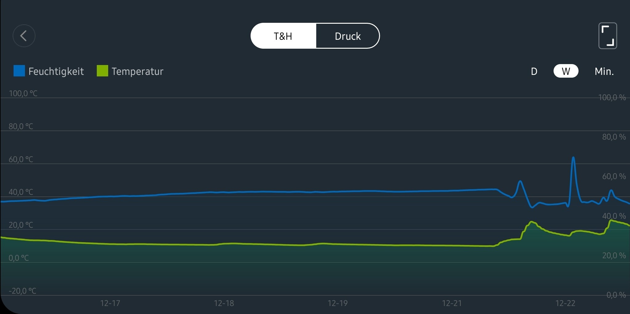

But I’d like to know if there’s something, which causes these glitches in the first place. What I find most startling is, those glitches won’t come up in the app.
notice: the Peak in humidity is boiling water, the sensor is right by the water boiler
Maybe the app filters them out too? I think I’ve noticed these more often when the battery is weaker, but I can’t say that for sure. The other measurements seem reasonable. Maybe the sensor sends these specific values (+100, -100) when something goes wrong in the sensor? I also got one very high humidity value - well above 100%!
Or maybe this is what happens if the gateway receives a garbled packet from the sensor. And that’s why the app knows to ignore it.
