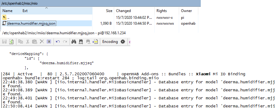

Hi Marcel, sorry to trouble you again, I have finally gotten around to trying what you recommended, it appears that the binding is still unable to find the file, i have done the chmod command recommended, as well as sudo chown openhab /etc/openhab2/misc/miio/deerma.humidifier.mjjsq.json

@emrys I don’t know how to further debug it. Looks like the location is right, but somehow the binding is not seeing it.
Your screenshot looks like the log without debugging info, enable that might give some more details
