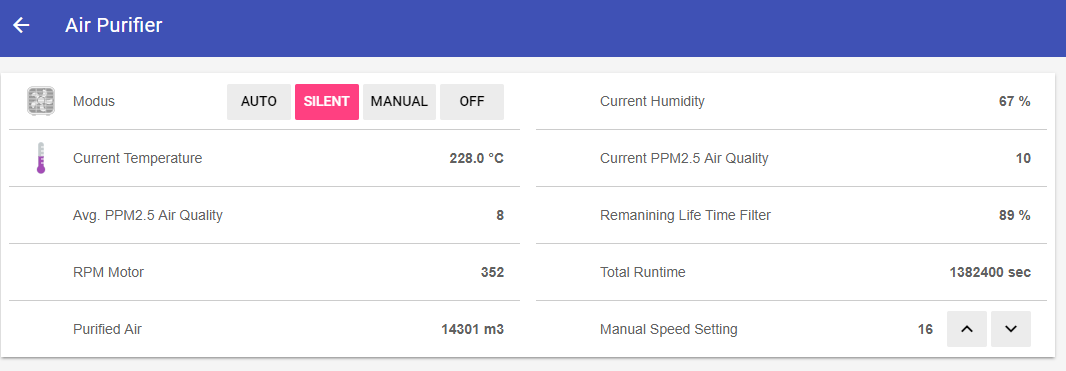

I did only add channels to the example sitemap below I was interested in. So there are more channels for users that are interested in those.
Some channels (e.g. Run Time, Temperature) need a data conversion. @marcel_verpaalen has that already on his list :slight_smile:

Sitemap:
			Text label="Xiaomi" icon="network"{
				Text label="Air Purifier"{
					Switch item=XAIR_mode label="Modus []" icon="fan" mappings=[auto=Auto, silent=Silent, favorite=Manual, idle=Off]
					//Switch item=XAIR_power
					Text item=XAIR_humidity label="Current Humidity [%d %%]"
					Text item=XAIR_temp label="Current Temperature"
					Text item=XAIR_airquality label="Current PPM2.5 Air Quality"
					Text item=XAIR_avgairquality label="Avg. PPM2.5 Air Quality"
					//Text item=XAIR_autodetect
					Text item=XAIR_filterlife label="Remanining Life Time Filter [%d %%]"
					Text item=XAIR_motorspeed label="RPM Motor"
					Text item=XAIR_runtime label="Total Runtime"
					Text item=XAIR_purifiedvol label="Purified Air"
					Setpoint item=XAIR_favlevel minValue=1 maxValue=16 step=1 label="Manual Speed Setting"

I add Thing. It was green “online”, token OK.
I add above items and sitemap.
I changed “miio:basic:035CAFE2” to mine “miio:basic:0401F6F5”
Buttons are working great. Equipment is changing states quickly and without any problems.
I have a problem with reading temperature, humidity, PM’s, filter lifetime and other data. Fields are empty. What can be the source of the problem?

Edit1: After two days I can see the same lack of information coming from the air purifier. ON/OFF and modes are working great.
Edit2: After update to 2.2 I can see the data coming from Mi Air purifier. But now situation is opposite - power channel is not working. “Manual Speed Setting” is working - I can hear the beep sound coming from the purifier. Speed was adjusted after manual (by finger) changing to favorite (lowest light on the purifier).
Just a short update.
After some fiddling around I have to say that:
on 2.1 - data (temperature, humidity, PM values) are not fetched from the air purifier but start/stop buttons are working.
on 2.2 snapshot - data is fetched but start/stop buttons doesn’t work.
Short update:
on 2.2 snapshot - it’s working.
