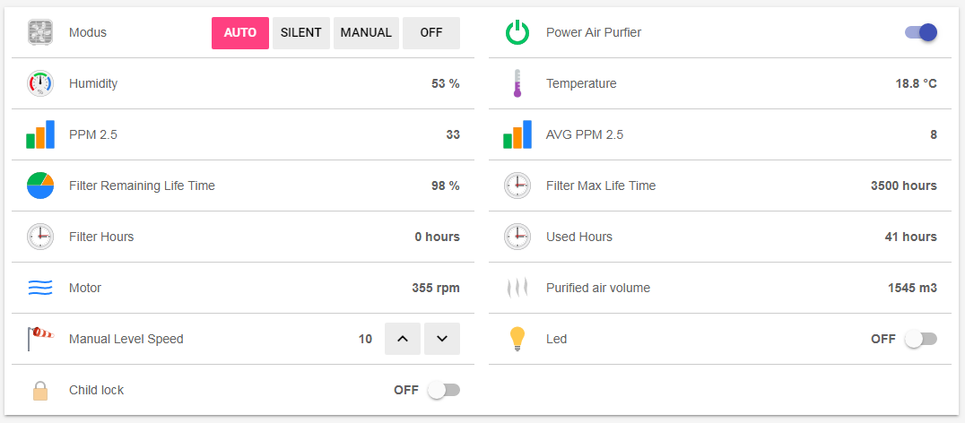

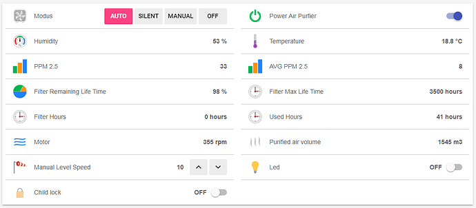

My remarks:
filterhours channels show nothing
Alltogether it work very very nice :wink:

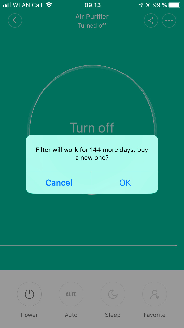

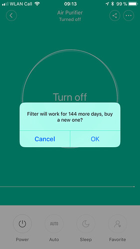

@marcel_verpaalen
I can’t see Filterhours in the MI App, the only thing the app show me is the remaining days on the Filter.
