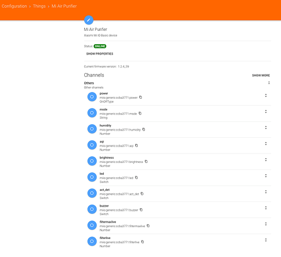

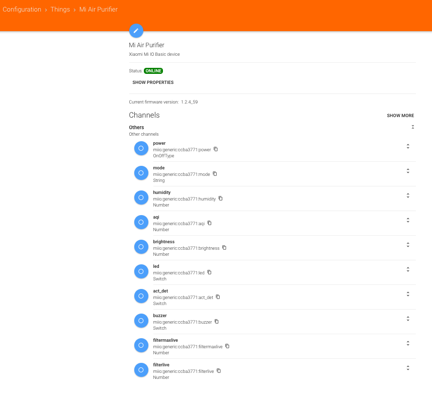

Now that the communication to the purifier is working, I build a very experimental version for it.
pls find it here
http://www.verpaalen.com/openhab2/org.openhab.binding.miio_2.2.0.SNAPSHOT.jar
So if it works as planned, it will discover your purifier. If it gets the tolken & communicates, it will change itself to a basic device.
Once it is a basic device, it should be able to read the database and dynamically add all relevant channels.
From than it should update the channels.
notes:
  • I found that sometimes paperUI does not update correctly, doing a browser refresh may help than.
  • Sometimes the initiation goes off and the channels don’t get updated. Than pls edit the thing, change something (e.g. location) and save again.
  • If no response is received, there is a hardcoded response (for testing purposes, so don’t be surpised).
Let me know if this is working for you as well. If not, please send me a debug log (not only the errors, but from the start of the binding until the error)
If test is successful I’ll replace the marketplace binding with this one

Hi I am new to openhanded and programming as well. I have couple of Xiaomi devices Including Air purifier 2. I added org.openhab.binding.miio_2.2.0.SNAPSHOT.jar in addon folder and was able to add Xiaomi Air purifier manually as things. Thanks a lot.
I have one issue here, As I have not much knowledge in programming I use paper UI all the time. I am trying to Add Swtich to power on and off Air purifier, but power channel is ONOFF type not switch and even when try to link that I get error. Though I can link buzzer, led aqi etc. But not power. Below is the screen shot
