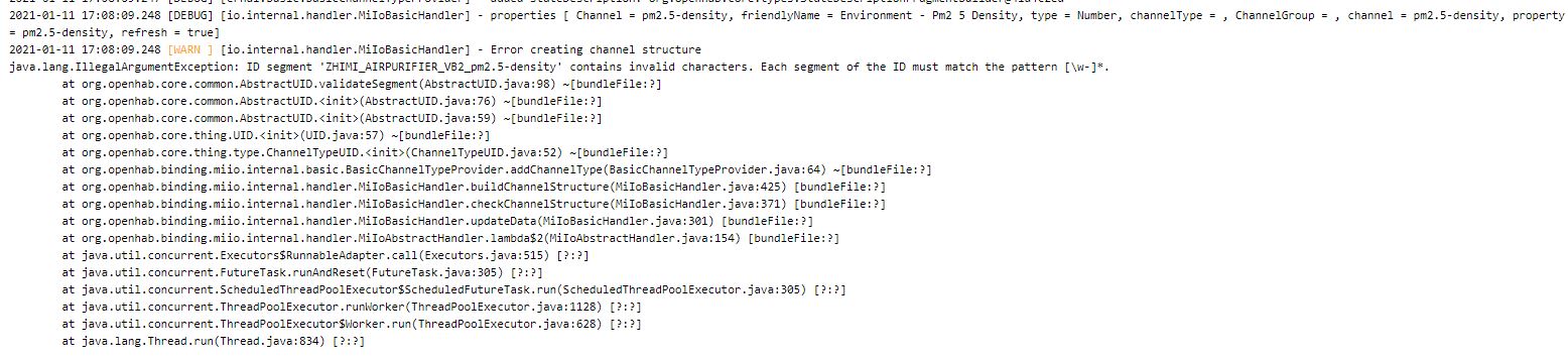

Communication error for Mi device at 192.168.0.28: Receive timed out
2020-11-11 11:32:18.710 [DEBUG] [nal.transport.MiIoAsyncCommunication] - No response from device 10245C99 at 192.168.0.28 for command {“id”:222,“method”:“get_properties”,“params”:[{“did”:“temperature”,“siid”:3,“piid”:8}]}.
2020-11-11 11:32:18.714 [DEBUG] [internal.handler.MiIoAbstractHandler] - Received response for xiaomi_air_purifier type: GET_PROPERTIES, result: {}, fullresponse: {“error”:“No Response”}
2020-11-11 11:32:18.717 [DEBUG] [internal.handler.MiIoAbstractHandler] - Error received: “No Response”
2020-11-11 11:32:19.371 [DEBUG] [internal.handler.MiIoAbstractHandler] - Received response for xiaomi_air_purifier type: GET_PROPERTIES, result: [{“did”:“temperature”,“siid”:3,“piid”:8,“code”:0,“value”:22.600000}], fullresponse: {“id”:222,“result”:[{“did”:“temperature”,“siid”:3,“piid”:8,“code”:0,“value”:22.600000}]}
2020-11-11 11:32:19.381 [vent.ItemStateChangedEvent] - XAP_kid_Display changed from ON to OFF
2020-11-11 11:32:19.689 [DEBUG] [internal.handler.MiIoAbstractHandler] - Received response for xiaomi_air_purifier type: GET_PROPERTIES, result: [{“did”:“on1”,“siid”:6,“piid”:6,“code”:0,“value”:true}], fullresponse: {“id”:223,“result”:[{“did”:“on1”,“siid”:6,“piid”:6,“code”:0,“value”:true}]}
2020-11-11 11:32:19.791 [DEBUG] [internal.handler.MiIoAbstractHandler] - Received response for xiaomi_air_purifier type: MIIO_INFO, result: {“life”:1215479,“uid”:6284166546,“model”:“zhimi.airpurifier.mb3”,“token”:“fd4acce85f1e0156a8881188e7f0294e”,“fw_ver”:“2.0.5”,“mcu_fw_ver”:“0017”,“miio_ver”:“0.0.5”,“hw_ver”:“esp32”,“mmfree”:64608,“mac”:“50:EC:50:89:FC:29”,“wifi_fw_ver”:“v3.1.4-56-g8ffb04960”,“ap”:{“ssid”:“wifi”,“bssid”:“38:43:7D:EE:69:49”,“rssi”:-53,“primary”:1},“netif”:{“localIp”:“192.168.0.28”,“mask”:“255.255.255.0”,“gw”:“192.168.0.1”}}, fullresponse: {“id”:225,“result”:{“life”:1215479,“uid”:6284166546,“model”:“zhimi.airpurifier.mb3”,“token”:“fd4acce85f1e0156a8881188e7f0294e”,“fw_ver”:“2.0.5”,“mcu_fw_ver”:“0017”,“miio_ver”:“0.0.5”,“hw_ver”:“esp32”,“mmfree”:64608,“mac”:“50:EC:50:89:FC:29”,“wifi_fw_ver”:“v3.1.4-56-g8ffb04960”,“ap”:{“ssid”:“wifi”,“bssid”:“38:43:7D:EE:69:49”,“rssi”:-53,“primary”:1},“netif”:{“localIp”:“192.168.0.28”,“mask”:“255.255.255.0”,“gw”:“192.168.0.1”}}}
2020-11-11 11:32:19.949 [DEBUG] [internal.handler.MiIoAbstractHandler] - Received response for xiaomi_air_purifier type: GET_PROPERTIES, result: [{“did”:“physical-controls-locked”,“siid”:7,“piid”:1,“code”:0,“value”:true}], fullresponse: {“id”:224,“result”:[{“did”:“physical-controls-locked”,“siid”:7,“piid”:1,“code”:0,“value”:true}]}
2020-11-11 11:32:19.959 [vent.ItemStateChangedEvent] - XAP_kid_Power changed from OFF to ON
2020-11-11 11:32:20.225 [DEBUG] [internal.handler.MiIoAbstractHandler] - Received response for xiaomi_air_purifier type: GET_PROPERTIES, result: [{“did”:“on”,“siid”:2,“piid”:2,“code”:0,“value”:false}], fullresponse: {“id”:226,“result”:[{“did”:“on”,“siid”:2,“piid”:2,“code”:0,“value”:false}]}
2020-11-11 11:32:20.229 [DEBUG] [io.internal.handler.MiIoBasicHandler] - Error updating miio:basic:xiaomi_air_purifier property Pm25Density with ‘false’ : java.lang.NumberFormatException: null
2020-11-11 11:32:20.511 [DEBUG] [internal.handler.MiIoAbstractHandler] - Received response for xiaomi_air_purifier type: GET_PROPERTIES, result: [{“did”:“pm2.5-density”,“siid”:3,“piid”:6,“code”:0,“value”:1}], fullresponse: {“id”:227,“result”:[{“did”:“pm2.5-density”,“siid”:3,“piid”:6,“code”:0,“value”:1}]}
2020-11-11 11:32:20.519 [vent.ItemStateChangedEvent] - XAP_kid_Humidity changed from 46 to 1
2020-11-11 11:32:20.812 [DEBUG] [internal.handler.MiIoAbstractHandler] - Received response for xiaomi_air_purifier type: GET_PROPERTIES, result: [{“did”:“relative-humidity”,“siid”:3,“piid”:7,“code”:0,“value”:46}], fullresponse: {“id”:228,“result”:[{“did”:“relative-humidity”,“siid”:3,“piid”:7,“code”:0,“value”:46}]}
2020-11-11 11:32:20.823 [vent.ItemStateChangedEvent] - XAP_kid_Temperature changed from 22.600000 to 46
2020-11-11 11:32:21.110 [DEBUG] [internal.handler.MiIoAbstractHandler] - Received response for xiaomi_air_purifier type: GET_PROPERTIES, result: [{“did”:“temperature”,“siid”:3,“piid”:8,“code”:0,“value”:22.600000}], fullresponse: {“id”:229,“result”:[{“did”:“temperature”,“siid”:3,“piid”:8,“code”:0,“value”:22.600000}]}
2020-11-11 11:32:21.437 [DEBUG] [internal.handler.MiIoAbstractHandler] - Received response for xiaomi_air_purifier type: GET_PROPERTIES, result: [{“did”:“on1”,“siid”:6,“piid”:6,“code”:0,“value”:true}], fullresponse: {“id”:230,“result”:[{“did”:“on1”,“siid”:6,“piid”:6,“code”:0,“value”:true}]}
2020-11-11 11:32:47.306 [DEBUG] [io.internal.handler.MiIoBasicHandler] - Periodic update for ‘miio:basic:xiaomi_air_purifier’ (miio:basic)
2020-11-11 11:32:47.311 [DEBUG] [nal.transport.MiIoAsyncCommunication] - Command added to Queue {“id”:232,“method”:“get_properties”,“params”:[{“did”:“on”,“siid”:2,“piid”:2}]} → 192.168.0.28 (Device: 10245C99 token: FD4ACCE8XXXXXXXXXXXXXXXXE7F0294E Queue: 1)
2020-11-11 11:32:47.314 [DEBUG] [nal.transport.MiIoAsyncCommunication] - Command added to Queue {“id”:233,“method”:“get_properties”,“params”:[{“did”:“pm2.5-density”,“siid”:3,“piid”:6}]} → 192.168.0.28 (Device: 10245C99 token: FD4ACCE8XXXXXXXXXXXXXXXXE7F0294E Queue: 2)
2020-11-11 11:32:47.318 [DEBUG] [nal.transport.MiIoAsyncCommunication] - Command added to Queue {“id”:234,“method”:“get_properties”,“params”:[{“did”:“relative-humidity”,“siid”:3,“piid”:7}]} → 192.168.0.28 (Device: 10245C99 token: FD4ACCE8XXXXXXXXXXXXXXXXE7F0294E Queue: 3)
2020-11-11 11:32:47.322 [DEBUG] [nal.transport.MiIoAsyncCommunication] - Command added to Queue {“id”:235,“method”:“get_properties”,“params”:[{“did”:“temperature”,“siid”:3,“piid”:8}]} → 192.168.0.28 (Device: 10245C99 token: FD4ACCE8XXXXXXXXXXXXXXXXE7F0294E Queue: 4)
2020-11-11 11:32:47.326 [DEBUG] [nal.transport.MiIoAsyncCommunication] - Command added to Queue {“id”:236,“method”:“get_properties”,“params”:[{“did”:“on1”,“siid”:6,“piid”:6}]} → 192.168.0.28 (Device: 10245C99 token: FD4ACCE8XXXXXXXXXXXXXXXXE7F0294E Queue: 5)
2020-11-11 11:32:47.329 [DEBUG] [nal.transport.MiIoAsyncCommunication] - Command added to Queue {“id”:237,“method”:“get_properties”,“params”:[{“did”:“physical-controls-locked”,“siid”:7,“piid”:1}]} → 192.168.0.28 (Device: 10245C99 token: FD4ACCE8XXXXXXXXXXXXXXXXE7F0294E Queue: 6)
2020-11-11 11:32:47.333 [DEBUG] [nal.transport.MiIoAsyncCommunication] - Command added to Queue {“id”:238,“method”:“miIO.info”,“params”:} → 192.168.0.28 (Device: 10245C99 token: FD4ACCE8XXXXXXXXXXXXXXXXE7F0294E Queue: 7)
2020-11-11 11:32:47.375 [DEBUG] [internal.handler.MiIoAbstractHandler] - Received response for xiaomi_air_purifier type: GET_PROPERTIES, result: [{“did”:“physical-controls-locked”,“siid”:7,“piid”:1,“code”:0,“value”:true}], fullresponse: {“id”:231,“result”:[{“did”:“physical-controls-locked”,“siid”:7,“piid”:1,“code”:0,“value”:true}]}
2020-11-11 11:32:47.752 [DEBUG] [internal.handler.MiIoAbstractHandler] - Received response for xiaomi_air_purifier type: GET_PROPERTIES, result: [{“did”:“pm2.5-density”,“siid”:3,“piid”:6,“code”:0,“value”:1}], fullresponse: {“id”:233,“result”:[{“did”:“pm2.5-density”,“siid”:3,“piid”:6,“code”:0,“value”:1}]}
2020-11-11 11:32:47.971 [DEBUG] [internal.handler.MiIoAbstractHandler] - Received response for xiaomi_air_purifier type: GET_PROPERTIES, result: [{“did”:“on”,“siid”:2,“piid”:2,“code”:0,“value”:false}], fullresponse: {“id”:232,“result”:[{“did”:“on”,“siid”:2,“piid”:2,“code”:0,“value”:false}]}
2020-11-11 11:32:47.974 [DEBUG] [io.internal.handler.MiIoBasicHandler] - Error updating miio:basic:xiaomi_air_purifier property RelativeHumidity with ‘false’ : java.lang.NumberFormatException: null
2020-11-11 11:32:48.260 [DEBUG] [internal.handler.MiIoAbstractHandler] - Received response for xiaomi_air_purifier type: GET_PROPERTIES, result: [{“did”:“relative-humidity”,“siid”:3,“piid”:7,“code”:0,“value”:46}], fullresponse: {“id”:234,“result”:[{“did”:“relative-humidity”,“siid”:3,“piid”:7,“code”:0,“value”:46}]}
2020-11-11 11:32:48.568 [DEBUG] [internal.handler.MiIoAbstractHandler] - Received response for xiaomi_air_purifier type: GET_PROPERTIES, result: [{“did”:“temperature”,“siid”:3,“piid”:8,“code”:0,“value”:22.600000}], fullresponse: {“id”:235,“result”:[{“did”:“temperature”,“siid”:3,“piid”:8,“code”:0,“value”:22.600000}]}
2020-11-11 11:32:48.872 [DEBUG] [internal.handler.MiIoAbstractHandler] - Received response for xiaomi_air_purifier type: GET_PROPERTIES, result: [{“did”:“on1”,“siid”:6,“piid”:6,“code”:0,“value”:true}], fullresponse: {“id”:236,“result”:[{“did”:“on1”,“siid”:6,“piid”:6,“code”:0,“value”:true}]}
2020-11-11 11:32:48.975 [DEBUG] [internal.handler.MiIoAbstractHandler] - Received response for xiaomi_air_purifier type: MIIO_INFO, result: {“life”:1215508,“uid”:6284166546,“model”:“zhimi.airpurifier.mb3”,“token”:“fd4acce85f1e0156a8881188e7f0294e”,“fw_ver”:“2.0.5”,“mcu_fw_ver”:“0017”,“miio_ver”:“0.0.5”,“hw_ver”:“esp32”,“mmfree”:64604,“mac”:“50:EC:50:89:FC:29”,“wifi_fw_ver”:“v3.1.4-56-g8ffb04960”,“ap”:{“ssid”:“wifi”,“bssid”:“38:43:7D:EE:69:49”,“rssi”:-53,“primary”:1},“netif”:{“localIp”:“192.168.0.28”,“mask”:“255.255.255.0”,“gw”:“192.168.0.1”}}, fullresponse: {“id”:238,“result”:{“life”:1215508,“uid”:6284166546,“model”:“zhimi.airpurifier.mb3”,“token”:“fd4acce85f1e0156a8881188e7f0294e”,“fw_ver”:“2.0.5”,“mcu_fw_ver”:“0017”,“miio_ver”:“0.0.5”,“hw_ver”:“esp32”,“mmfree”:64604,“mac”:“50:EC:50:89:FC:29”,“wifi_fw_ver”:“v3.1.4-56-g8ffb04960”,“ap”:{“ssid”:“wifi”,“bssid”:“38:43:7D:EE:69:49”,“rssi”:-53,“primary”:1},“netif”:{“localIp”:“192.168.0.28”,“mask”:“255.255.255.0”,“gw”:“192.168.0.1”}}}
2020-11-11 11:33:17.335 [DEBUG] [io.internal.handler.MiIoBasicHandler] - Periodic update for ‘miio:basic:xiaomi_air_purifier’ (miio:basic)
2020-11-11 11:33:17.340 [DEBUG] [nal.transport.MiIoAsyncCommunication] - Command added to Queue {“id”:239,“method”:“get_properties”,“params”:[{“did”:“on”,“siid”:2,“piid”:2}]} → 192.168.0.28 (Device: 10245C99 token: FD4ACCE8XXXXXXXXXXXXXXXXE7F0294E Queue: 1)
2020-11-11 11:33:17.343 [DEBUG] [nal.transport.MiIoAsyncCommunication] - Command added to Queue {“id”:240,“method”:“get_properties”,“params”:[{“did”:“pm2.5-density”,“siid”:3,“piid”:6}]} → 192.168.0.28 (Device: 10245C99 token: FD4ACCE8XXXXXXXXXXXXXXXXE7F0294E Queue: 2)
2020-11-11 11:33:17.347 [DEBUG] [nal.transport.MiIoAsyncCommunication] - Command added to Queue {“id”:241,“method”:“get_properties”,“params”:[{“did”:“relative-humidity”,“siid”:3,“piid”:7}]} → 192.168.0.28 (Device: 10245C99 token: FD4ACCE8XXXXXXXXXXXXXXXXE7F0294E Queue: 3)
2020-11-11 11:33:17.350 [DEBUG] [nal.transport.MiIoAsyncCommunication] - Command added to Queue {“id”:242,“method”:“get_properties”,“params”:[{“did”:“temperature”,“siid”:3,“piid”:8}]} → 192.168.0.28 (Device: 10245C99 token: FD4ACCE8XXXXXXXXXXXXXXXXE7F0294E Queue: 4)
2020-11-11 11:33:17.354 [DEBUG] [nal.transport.MiIoAsyncCommunication] - Command added to Queue {“id”:243,“method”:“get_properties”,“params”:[{“did”:“on1”,“siid”:6,“piid”:6}]} → 192.168.0.28 (Device: 10245C99 token: FD4ACCE8XXXXXXXXXXXXXXXXE7F0294E Queue: 5)
2020-11-11 11:33:17.357 [DEBUG] [nal.transport.MiIoAsyncCommunication] - Command added to Queue {“id”:244,“method”:“get_properties”,“params”:[{“did”:“physical-controls-locked”,“siid”:7,“piid”:1}]} → 192.168.0.28 (Device: 10245C99 token: FD4ACCE8XXXXXXXXXXXXXXXXE7F0294E Queue: 6)
2020-11-11 11:33:17.432 [DEBUG] [internal.handler.MiIoAbstractHandler] - Received response for xiaomi_air_purifier type: GET_PROPERTIES, result: [{“did”:“physical-controls-locked”,“siid”:7,“piid”:1,“code”:0,“value”:true}], fullresponse: {“id”:237,“result”:[{“did”:“physical-controls-locked”,“siid”:7,“piid”:1,“code”:0,“value”:true}]}
2020-11-11 11:33:18.210 [DEBUG] [internal.handler.MiIoAbstractHandler] - Received response for xiaomi_air_purifier type: GET_PROPERTIES, result: [{“did”:“on”,“siid”:2,“piid”:2,“code”:0,“value”:false}], fullresponse: {“id”:239,“result”:[{“did”:“on”,“siid”:2,“piid”:2,“code”:0,“value”:false}]}
2020-11-11 11:33:18.215 [DEBUG] [io.internal.handler.MiIoBasicHandler] - Error updating miio:basic:xiaomi_air_purifier property Pm25Density with ‘false’ : java.lang.NumberFormatException: null
2020-11-11 11:33:18.494 [DEBUG] [internal.handler.MiIoAbstractHandler] - Received response for xiaomi_air_purifier type: GET_PROPERTIES, result: [{“did”:“pm2.5-density”,“siid”:3,“piid”:6,“code”:0,“value”:1}], fullresponse: {“id”:240,“result”:[{“did”:“pm2.5-density”,“siid”:3,“piid”:6,“code”:0,“value”:1}]}
2020-11-11 11:33:18.780 [DEBUG] [internal.handler.MiIoAbstractHandler] - Received response for xiaomi_air_purifier type: GET_PROPERTIES, result: [{“did”:“relative-humidity”,“siid”:3,“piid”:7,“code”:0,“value”:46}], fullresponse: {“id”:241,“result”:[{“did”:“relative-humidity”,“siid”:3,“piid”:7,“code”:0,“value”:46}]}
2020-11-11 11:33:19.071 [DEBUG] [internal.handler.MiIoAbstractHandler] - Received response for xiaomi_air_purifier type: GET_PROPERTIES, result: [{“did”:“temperature”,“siid”:3,“piid”:8,“code”:0,“value”:22.600000}], fullresponse: {“id”:242,“result”:[{“did”:“temperature”,“siid”:3,“piid”:8,“code”:0,“value”:22.600000}]}
2020-11-11 11:33:19.392 [DEBUG] [internal.handler.MiIoAbstractHandler] - Received response for xiaomi_air_purifier type: GET_PROPERTIES, result: [{“did”:“on1”,“siid”:6,“piid”:6,“code”:0,“value”:true}], fullresponse: {“id”:243,“result”:[{“did”:“on1”,“siid”:6,“piid”:6,“code”:0,“value”:true}]}
I disabled properties with “false” in json file. Kept only few properties
