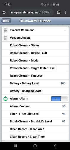

The Xiaomi G1 was then listed in the inbox and I added most of the items. Only a few seem to have values, but are picking up correct values.
I just need to look at identifying which ones should return data and how I can issue commands as well as view maps/progress.
Also, in Paper UI I get an Error 500 trying to update the Thing if I try to change the name or description, so it has to stay as “Unknown Mi IO Device”
I’ve attached screenshot using Basic UI ( not had much time to access PC, so done most of this on my phone).

I’m not sure why most of the values for the channels are blank - unless the Classic UI can’t display them.
