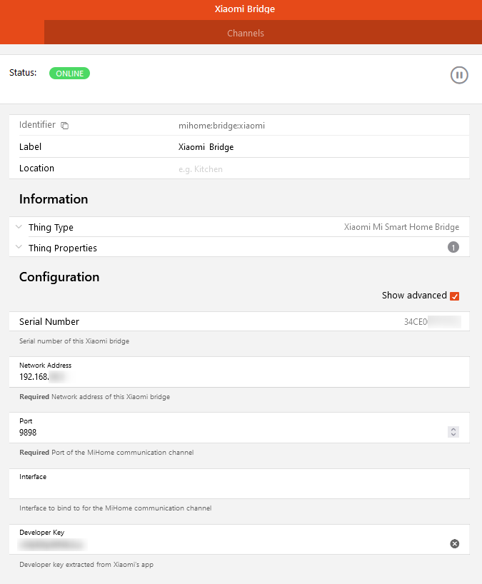

This doesn’t work with me unfortunately.
I’m running OH3.2.0-stable and the bridge goes offline every 5mins.
I can’t put in the serialNumber in the GUI directly, that input field is grey with my installation - I put it in “Code” and then it appears in the Thing-configuration in grey:
UID: mihome:bridge:xiaomi
label: Xiaomi  Bridge
thingTypeUID: mihome:bridge
configuration:
  ipAddress: 192.168.xx.yy
  serialNumber: 123456789012
  port: 9898
  key: *****
Do I miss something?
Looks correct to me. Here is my for reference. 2 suggestions:
  1. Maybe not edit the ID when creating the Thing?
  2. lower case the serial number?
Other than that, it looks exactly the same as mine.
Ok. THAT did the trick. I don’t know why, :man_shrugging: but yeah, after
  1. Scan for the gateway
  2. dumb “add as Thing” for it
  3. dumb “add as Thing” for all devices
=> it’s still online after 5mins. Even without pasting the developer key into the bridge-Thing?
so - never rename the Xiaomi-Things… I guess!
