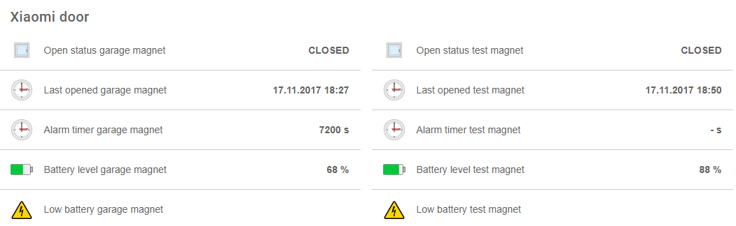

I initialized the Aqara door sensor, and I can comfirm I see the battery level
Left is original, right is Aqara (didn’t entered value for timer)
Thats awesome @wars !! Thanks so much for confirming this. Looks like the issue is only on the smartthings side with the Aqara sensors.
