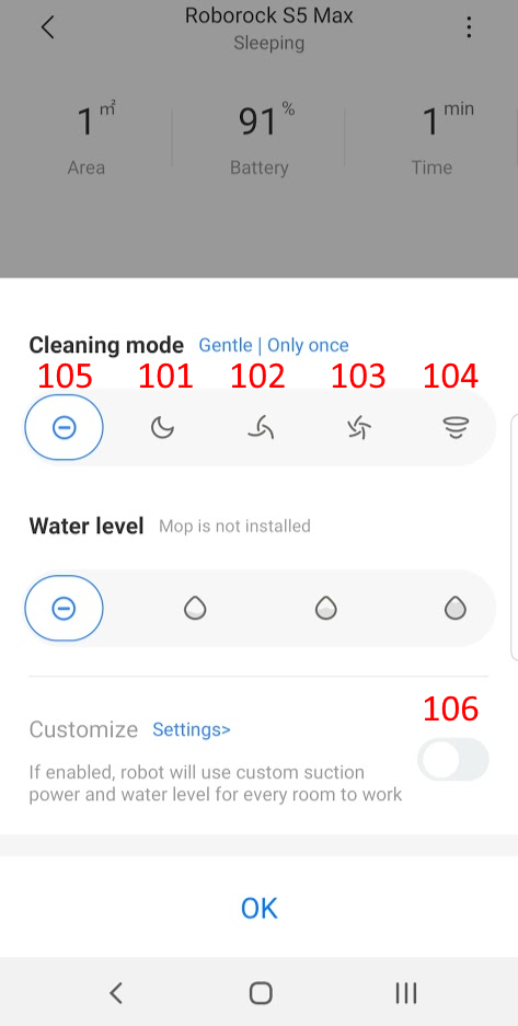

No, that’s not right. I have the new Roborock Vacuum S5 Max (s5e) and the fan mode is as follows (data “fan_power” via the “get_status” command):
101=Silent
102=Balanced
103=Turbo
104=Max
105=Gentle
106=Customize (Auto)
I marked this on the image in the Xiaomi app settings:
However, the customize switch is only active when the mop mode has been also set correctly.
