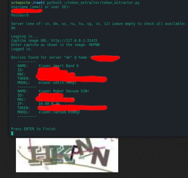

Note: for me the python token extractor also did not work… This only supports the capcha feature. But if you are ‘lucky’ like I was as well, you also need the 2FA code. This is not (yet?) supported by the python tool. miio binding will soon support both capcha and 2FA features

The token extractor works for me and I can communicate with my Roborock. However, I still get this error:
Error logging on to Xiaomi cloud (0): Error getting logon location URL. Return code: 87001
