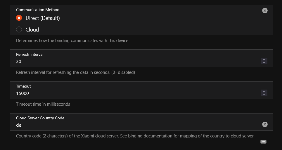

It’s weird as I am using the direct connection:
Any idea why I am getting the above mentioned error-msg ?
Any hints/ideas are welcome
Even in case of direct connections, you need the cloud to get the encryption keys (token) for the devices. Without the token you can’t communicate direct to the devices.
The cloud connectivity is broken since Xiaomi introduced a new capcha & 2FA check for the login which is not supported by openhab miio binding yet.
This is why you see the error in the log.
See a few posts above, about the token extractor. Temporarily workaround to get the token for openhab.
