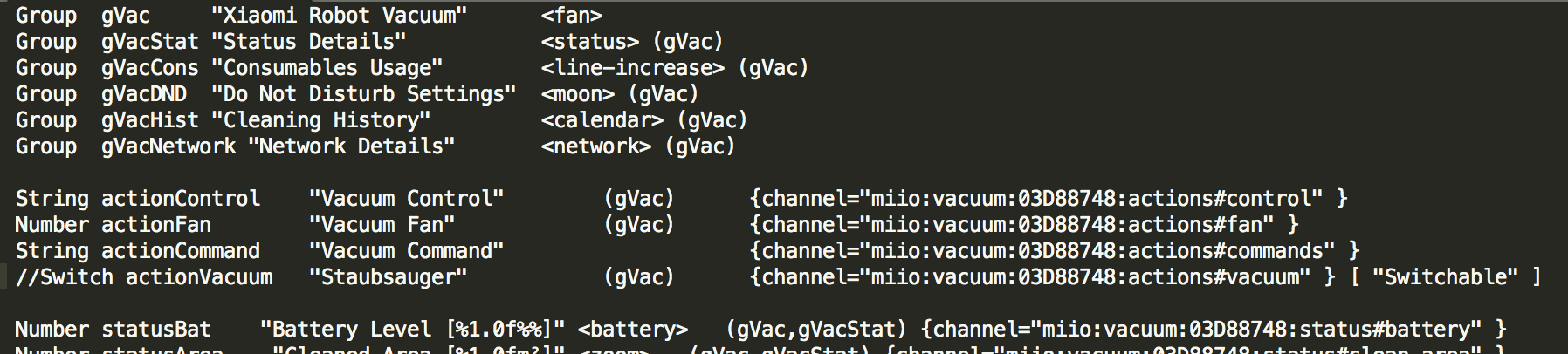

Did you see the screenshot? my item file is named xiaomi_vacuum.items… My items are named with the right channel and no item seems to work… i reinstall binding and things…thing is online… but i am not sure what is about this error in the bottom
Can it be your OH version is 2.1, or early 2.2 version. For those there was a bug wrt to the firmware functionality which gave a 404 error. I wouldn’t know. You may want to restart OH, as it does not always handle item changes very well.
If you don’t have updates, please check the debug log of the binding (see how to enable in the very first post)
that may give some hints to what is going on

yes, i got 2.1 on OpenhabianPI…
If i enable this line the sitemap is not working anymore and everything
Switch actionVacuum "Staubsauger" (gVac) {channel="miio:vacuum:03D88748:actions#vacuum" } [ "Switchable" ]
Group item=gVac {
Switch item=actionControl mappings=[vacuum="Vacuum", pause="Pause",spot="Spot", dock="Dock"]
Switch item=actionFan mappings=[38="Silent", 60="Normal", 77="Power",90="Full", -1="Custom"]
Switch item=actionVacuum
Default item=statusBat

what if you remove the [ "Switchable" ]
part. Does that make a difference. Why do you have that?
Yes, then the item is working
BUT…i need this item for the openhab simulation for Alexa or Google Home…
I have not used it, but as far as I know you need to add that to your item file instead of to the sitemap
yes yes, i only have the “Switch item=actionVacuum” in my sitemap in my item file is this line…
when you put the switchable part BEFoRE the channel part.
does this change something?
I see that this channel type is a String
How to use it? What string to send?

In paperUI you will see the options in the dropdown
If you want to define it in the basic/classic UI use the values as below
<option value="main_brush_work_time">Reset Mainbrush</option>
<option value="side_brush_work_time">Reset Sidebrush</option>
<option value="filter_work_time">Reset Filter</option>
<option value="sensor_dirty_time">Reset Sensors</option>
As @shorty707 already said: http://docs.openhab.org/configuration/items.html#syntax
All parts must be given in the order shown
