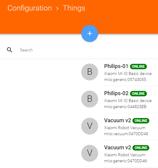

In the inbox 2 Philips Zhirui and a vacuum cleaner of the second version were automatically added.
  1. Why is the vacuum cleaner added 2 times?
    If you remove the miio:generic, it appears again.
  2. Philips Zhirui is defined as a generic (it works), is that correct?
  3. How does it work miio:generic:05743055:switchscene (Philips Zhirui)?
  4. How to use miio:generic:05743055:dv (Philips Zhirui)? If you set a value, it is immediately reset to zero.

Those are good questions, let me try to answer them…
There are actually 2 methods in use to discover the miio devices, not all devices can be use both, but many do.
One method gets the information from announcing of the devices via mDNS. The model is send along, so the right thingtype can be created at discovery right away. This method is not suppoeted sometimes e.g. Philips’ bulbs, and the vacuum when not connected to the Internet.
The 2nd one that creates the ‘generic’ entry is the one that almost all devices use, the unfortunate is that the device model is not known at the time of discovery. Only once the token is entered, the thingtype can bet determined. Once determined, it updates the thingtype to the right one (e.g. vacuum for your vacuum, and basic for the others).
Internally both end up in the same thingtype, hence it does not matter which of the 2 you accept. You should avoid creating things for both at the same time.
This binding, unlike most bindings, creates the channels at runtime as it takes the information from database.
This is done to be simply support many different devices withou the need for coding.
This is why you see the entries for the channels being removed than created again. This is indeed fully normal and expected behavior.
