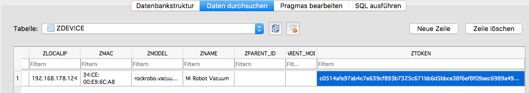

I used your steps to get the token from my iPhone. Weirdly, my token has a length of 96 characters:
37
That token is not accepted in the Thing Configuration (PaperUI).
When I use only the first 32 characters of the token, the Robot is shown as “Online”, but still, the communication doesn’t work:
16:01:36.849 [DEBUG] [ding.miio.internal.MiIoCommunication] - Send command:{"id":385,"method":"get_status","params":[]} -> 192.168.178.124 (Device: 03D9BF2A token: C0514AFE97AB4C7E639CF893B7325C67) 16:01:36.855 [TRACE] [ding.miio.internal.MiIoCommunication] - Connection 192.168.178.124:46833 16:01:40.863 [DEBUG] [ding.miio.internal.MiIoCommunication] - Communication error for Mi IO device at 192.168.178.124: Receive timed out 16:01:40.865 [DEBUG] [ding.miio.internal.MiIoCommunication] - Reponse length <32 : 0 16:01:40.868 [TRACE] [ding.miio.internal.MiIoCommunication] - No response from device 03D9BF2A at 192.168.178.124 for command {"id":385,"method":"get_status","params":[]}. Message: Header : 21 31 00 50 00 00 00 00 03 D9 BF 2A 59 B2 A2 C0 checksum: 71 45 63 C2 8A 83 42 FC 94 CD 45 64 92 19 75 88 content : 88 DA D9 02 86 C7 16 8A 47 9B AA FF CD CB 5E 0C BF A5 CD C8 AE 64 93 BC EB 5B 48 52 6B 09 51 3D 02 87 7D 2B 6D A2 23 3E 9A E6 8E FA FA F3 F6 63 Header Details: Magic:21 31 Length: 80 Serial: 03 D9 BF 2A TS:2017-09-08 16:01:36 16:01:40.870 [TRACE] [ing.miio.handler.MiIoAbstractHandler] - Empty response received. 16:01:40.873 [DEBUG] [nding.miio.handler.MiIoVacuumHandler] - Error while updating 'miio:vacuum:3D9BF2A': java.lang.NullPointerException at org.openhab.binding.miio.handler.MiIoVacuumHandler.updateVacuumStatus(MiIoVacuumHandler.java:110)[205:org.openhab.binding.miio:2.2.0.SNAPSHOT] at org.openhab.binding.miio.handler.MiIoVacuumHandler.getStatusData(MiIoVacuumHandler.java:106)[205:org.openhab.binding.miio:2.2.0.SNAPSHOT] at org.openhab.binding.miio.handler.MiIoVacuumHandler.updateData(MiIoVacuumHandler.java:237)[205:org.openhab.binding.miio:2.2.0.SNAPSHOT] at java.util.concurrent.Executors$RunnableAdapter.call(Executors.java:511)[:1.8.0_144] at java.util.concurrent.FutureTask.runAndReset(FutureTask.java:308)[:1.8.0_144] at java.util.concurrent.ScheduledThreadPoolExecutor$ScheduledFutureTask.access$301(ScheduledThreadPoolExecutor.java:180)[:1.8.0_144] at java.util.concurrent.ScheduledThreadPoolExecutor$ScheduledFutureTask.run(ScheduledThreadPoolExecutor.java:294)[:1.8.0_144] at java.util.concurrent.ThreadPoolExecutor.runWorker(ThreadPoolExecutor.java:1149)[:1.8.0_144] at java.util.concurrent.ThreadPoolExecutor$Worker.run(ThreadPoolExecutor.java:624)[:1.8.0_144] at java.lang.Thread.run(Thread.java:748)[:1.8.0_144]
Do you know, what’s wrong with my token?
Thanks!!!

I used an Android device now, to get the token. The token is different from the one, I found via iOS/local backup.
I am facing other problems now, but wanted to let you know, that for an unknown reason, the token retrieval for iOS might end up with a token in an invalid format…

I understand the key seems to be decrypted and are now indeed 96 characters long.
I’ll add decryption for IOS keys to normal tokens in the next version

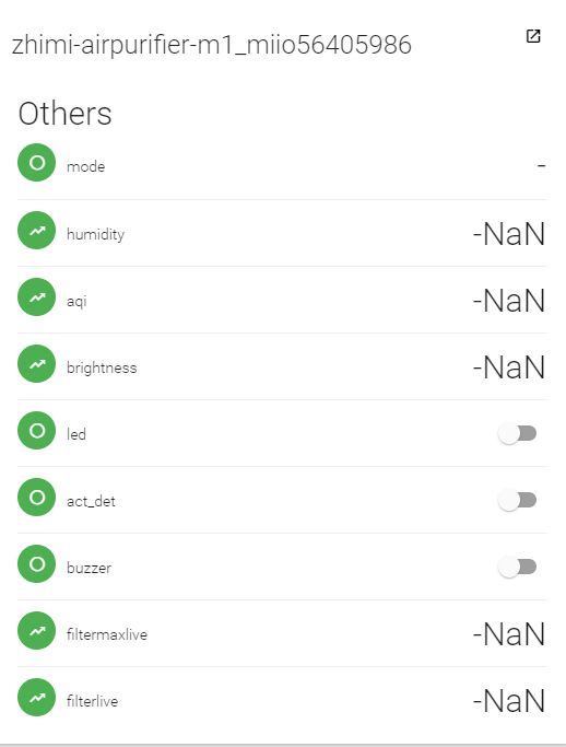

I have the air purifier
retrieved the token and added the thing .. works :wink:
is there sample items and sitemap for the purifier?
the auto channels are not working
