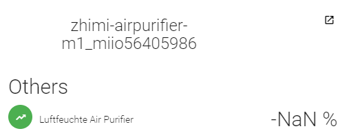

Which is actually correct because I deactivated simple mode. For some reasons the MIIO binding created them anyways in the previous version.
So I created now 1 item manually for humidity which is not working,
I will check debug logs tomorrow.
btw with the previous version the channels for LED and BUZZER worked.
A channel for temperature seems totally missing

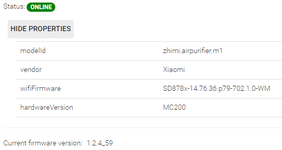

@shorty707 okay, I think I know what is going on.
Only version zhimi.airpurifier.m1 is currently in the database.
Pls go to advanced properties and change the model string to zhimi.airpurifier.m1
Than it will work as before.
There are 6 versions of the purifier. Let me know the exact version you have, which channels are different and I can add your specific model to the database.
does this help?
the device model string was already
@shorty707 thanks, indeed, than the model wasn’t the problem. Than the database needs to be modified. The source I used to find the channels did not specify exactly the model. it indicated was a 1, I guessed it was the m1
I would really like to see the debug (what is the device responding etc) and any channel you still miss.

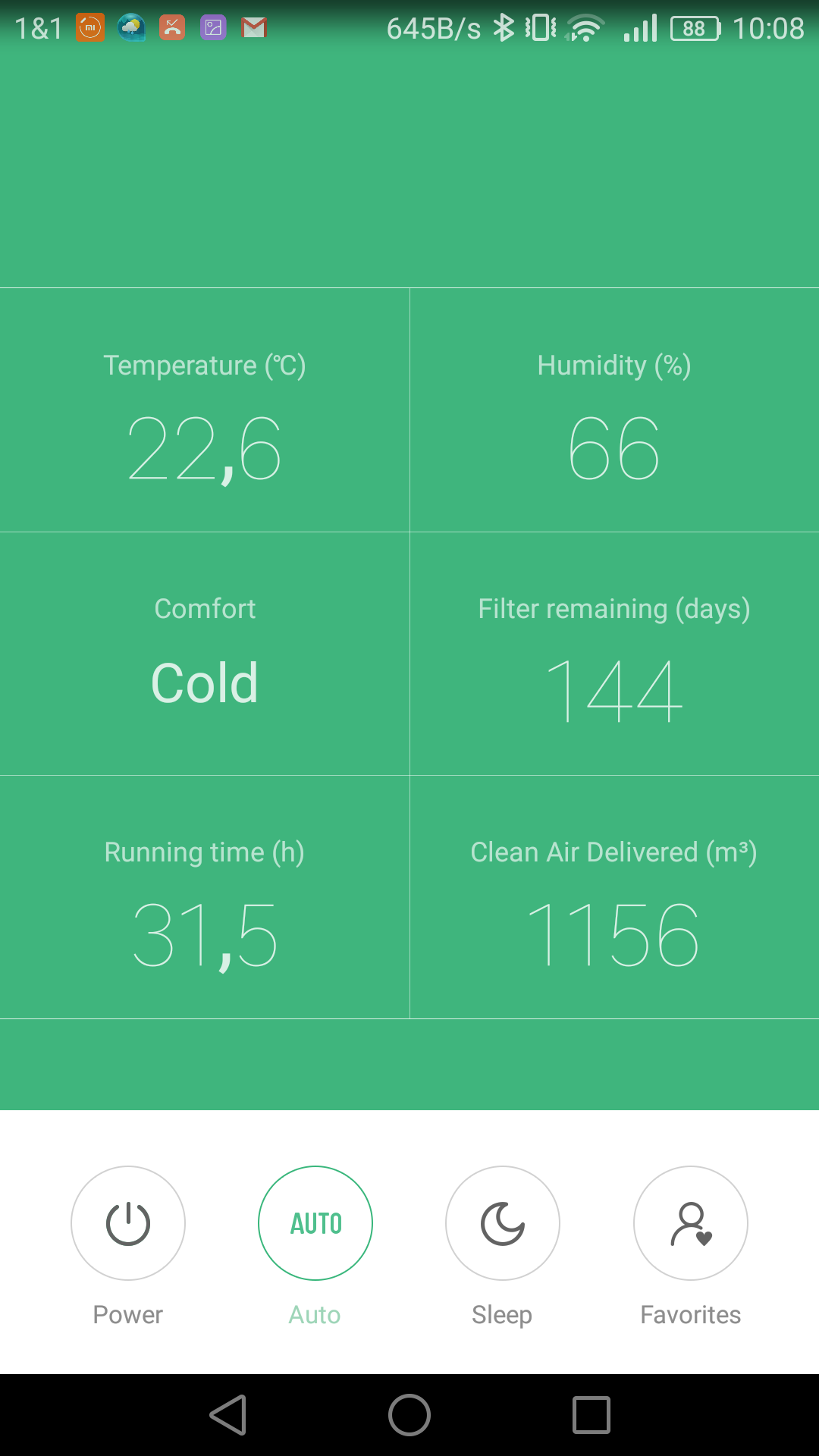

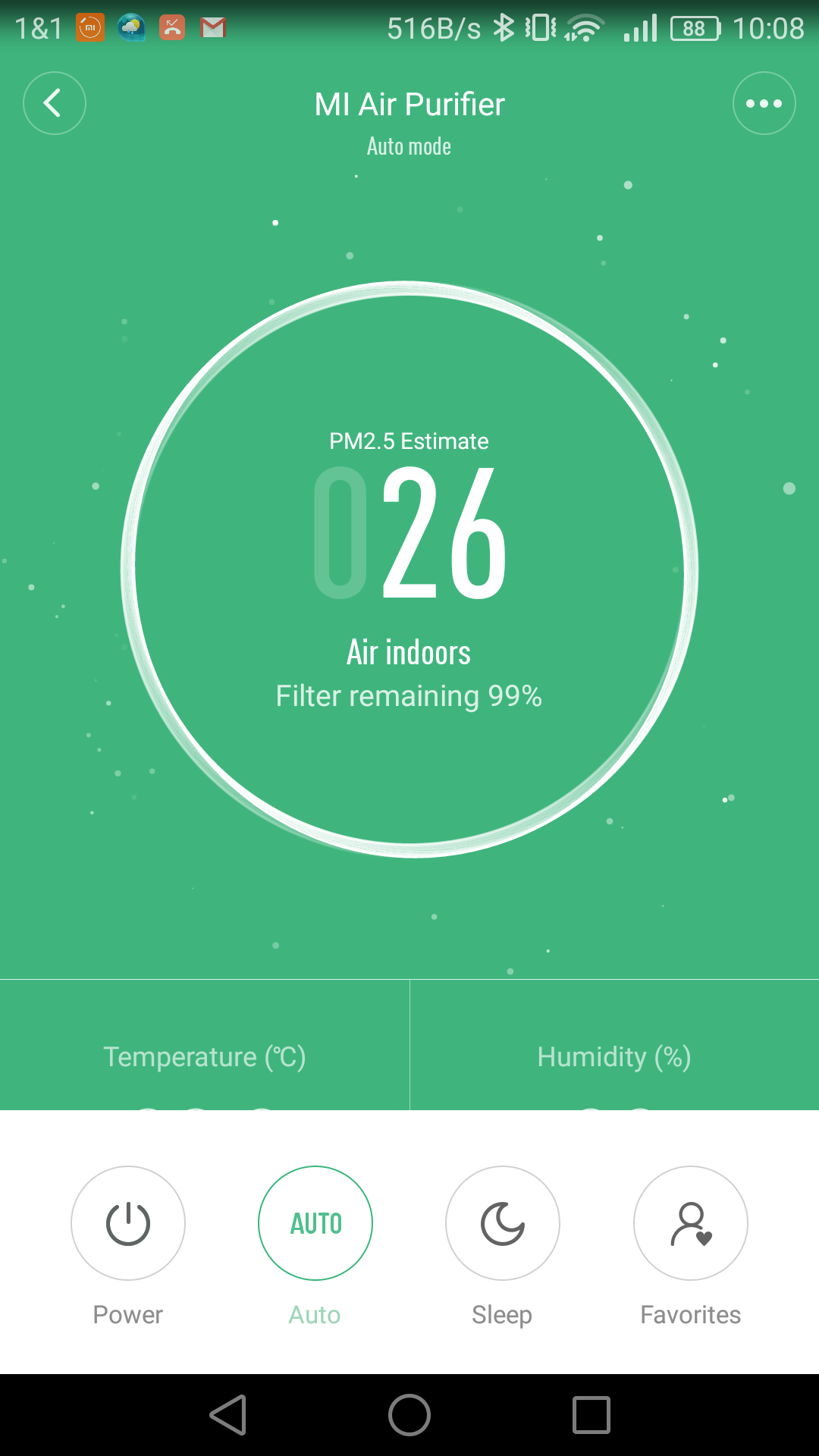

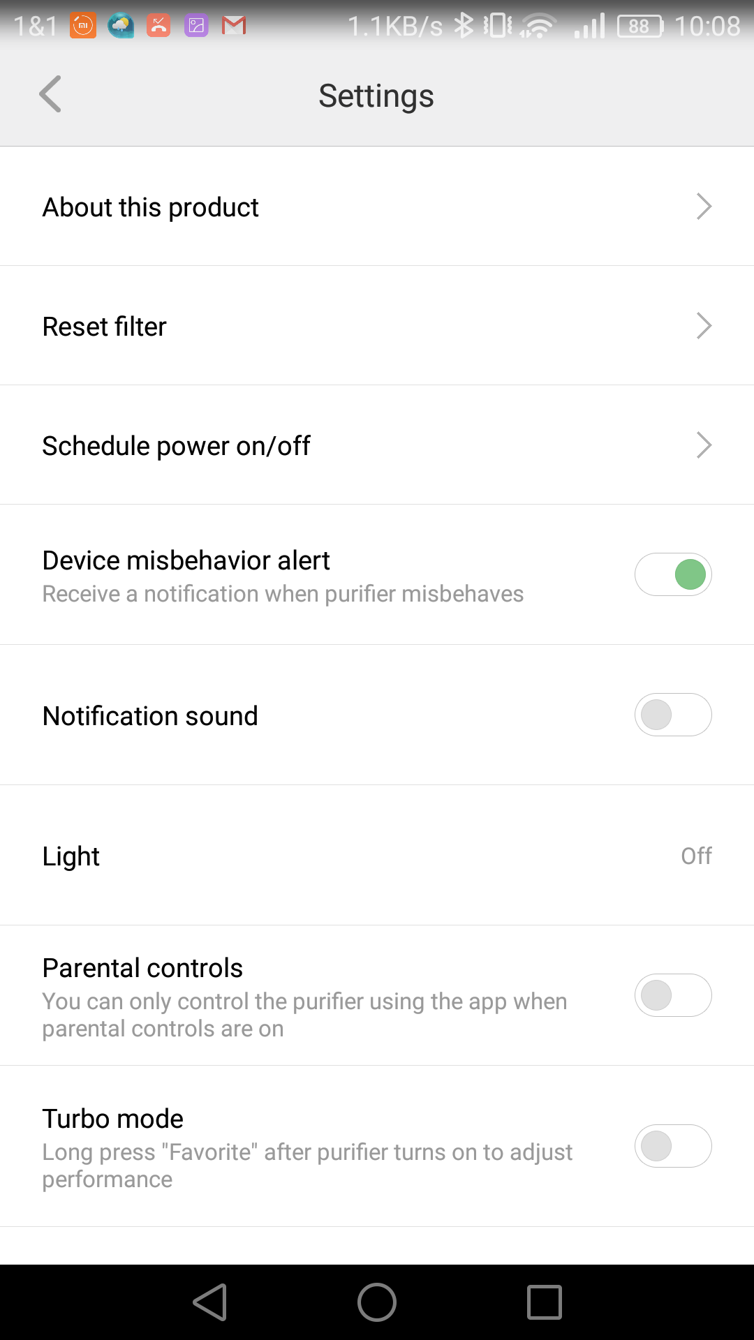

Here is the Information that can be read in the App…
from these I would derive the channels:
PM2.5 = Airquality (probably your AQI channel)
Temperature
Humidity
Comfort Level
Filter Remaining days
Filter Remaining percent
Running time
Clean Air delivered
MODE Select
Notification Sound (activates/deactives is the device confirms a setting chnage with a beep)
light (has 3 settings for the LED: off; bright; dim)
maybe another useful information for you:
the default binding config says the there is a 30second cycle for refresh…
I never see a cyclic communication in the log
Temperature
Humidity
Comfort Level
Running time
Clean Air delivered
MODE Select
Comfort Level should be local calculation on app
Clean Air delivered should be local calculation on app
Notification Sound = buzzer
light = brightness 0, 1, 2 > off; bright; dim
this should be cloud or a real channel
if it was only local caluclation then the value would be zero when installing the app on another device.

get_prop["led","act_det","buzzer","f1_hour","filter1_life"]
I’ll take another look @ the code
NB. I also know that paperUI sometimes needs a refresh when the channels are defined. They are there, but just not visible in the UI. (refresh with e.g. with F5 or reloading the page)
I created an item for that
String XAIR_commandchannel "Manual Command Channel" {channel="miio:basic:035CAFE2:actions#commands"}
tried to execute your command on console with smarthome:update … seems wrong approach :wink:
ah cool can fire that on paper ui … never seen this
15:56:09.436 [DEBUG] [nal.transport.MiIoAsyncCommunication] - Command added to Queue {"id":3,"method":"get_prop","params":["power","mode","humidity","aqi","bright"]} -> 192.168.1.73 (Device: 035CAFE2 token: 92CB1EE585A1B10982EA2A71DC23F26D Queue: 1)
15:56:09.465 [DEBUG] [inding.miio.handler.MiIoBasicHandler] - Locating action for channel actions#commands:get_prop["power","mode","humidity","aqi","bright"]
15:56:09.480 [DEBUG] [inding.miio.handler.MiIoBasicHandler] - Channel Id actions#commands not in mapping. Available:
15:56:09.507 [DEBUG] [inding.miio.handler.MiIoBasicHandler] - entries: mode : org.openhab.binding.miio.internal.basic.MiIoDeviceAction@14460c
15:56:09.517 [DEBUG] [inding.miio.handler.MiIoBasicHandler] - entries: brightness : org.openhab.binding.miio.internal.basic.MiIoDeviceAction@128f475
15:56:09.527 [DEBUG] [inding.miio.handler.MiIoBasicHandler] - entries: buzzer : org.openhab.binding.miio.internal.basic.MiIoDeviceAction@1a288aa
15:56:09.536 [DEBUG] [inding.miio.handler.MiIoBasicHandler] - entries: led : org.openhab.binding.miio.internal.basic.MiIoDeviceAction@8f37d1
15:56:09.546 [DEBUG] [inding.miio.handler.MiIoBasicHandler] - entries: power : org.openhab.binding.miio.internal.basic.MiIoDeviceAction@6b266a
15:56:09.565 [INFO ] [smarthome.event.ItemCommandEvent    ] - Item 'XAIR_commandchannel' received command get_prop["power","mode","humidity","aqi","bright"]
15:56:09.601 [INFO ] [marthome.event.ItemStateChangedEvent] - XAIR_commandchannel changed from get_prop to get_prop["power","mode","humidity","aqi","bright"]
15:56:09.861 [DEBUG] [ing.miio.handler.MiIoAbstractHandler] - Received response for 035CAFE2 type: GET_PROPERTY, result: ["on","auto",68,10,null], fullresponse: {"result":["on","auto",68,10,null],"id":3}
15:56:09.894 [INFO ] [marthome.event.ItemStateChangedEvent] - XAIR_commandchannel changed from get_prop["power","mode","humidity","aqi","bright"] to {"result":["on","auto",68,10,null],"id":3}
15:56:09.899 [DEBUG] [inding.miio.handler.MiIoBasicHandler] - Error while handing message {"result":["on","auto",68,10,null],"id":3}
java.lang.UnsupportedOperationException: JsonNull
	at com.google.gson.JsonElement.getAsString(JsonElement.java:191) [23:com.google.gson:2.3.1]
	at org.openhab.binding.miio.handler.MiIoBasicHandler.updateProperties(MiIoBasicHandler.java:331) [237:org.openhab.binding.miio:2.2.0.201709170737]
	at org.openhab.binding.miio.handler.MiIoBasicHandler.onMessageReceived(MiIoBasicHandler.java:349) [237:org.openhab.binding.miio:2.2.0.201709170737]
	at org.openhab.binding.miio.internal.transport.MiIoAsyncCommunication$MessageSenderThread.run(MiIoAsyncCommunication.java:209) [237:org.openhab.binding.miio:2.2.0.201709170737]
15:56:09.921 [INFO ] [marthome.event.ItemStateChangedEvent] - XAIR_mode changed from NULL to auto
15:56:09.946 [INFO ] [marthome.event.ItemStateChangedEvent] - XAIR_humidity changed from NULL to 68
15:56:09.967 [INFO ] [marthome.event.ItemStateChangedEvent] - XAIR_airquality changed from NULL to 10
second one timed out
15:59:00.534 [DEBUG] [nal.transport.MiIoAsyncCommunication] - Command added to Queue {"id":4,"method":"get_prop","params":["led","act_det","buzzer","f1_hour","filter1_life"]} -> 192.168.1.73 (Device: 035CAFE2 token: 92CB1EE585A1B10982EA2A71DC23F26D Queue: 1)
15:59:00.562 [DEBUG] [inding.miio.handler.MiIoBasicHandler] - Locating action for channel actions#commands:get_prop["led","act_det","buzzer","f1_hour","filter1_life"]
15:59:00.578 [DEBUG] [inding.miio.handler.MiIoBasicHandler] - Channel Id actions#commands not in mapping. Available:
15:59:00.588 [DEBUG] [inding.miio.handler.MiIoBasicHandler] - entries: mode : org.openhab.binding.miio.internal.basic.MiIoDeviceAction@14460c
15:59:00.597 [DEBUG] [inding.miio.handler.MiIoBasicHandler] - entries: brightness : org.openhab.binding.miio.internal.basic.MiIoDeviceAction@128f475
15:59:00.604 [DEBUG] [inding.miio.handler.MiIoBasicHandler] - entries: buzzer : org.openhab.binding.miio.internal.basic.MiIoDeviceAction@1a288aa
15:59:00.611 [DEBUG] [inding.miio.handler.MiIoBasicHandler] - entries: led : org.openhab.binding.miio.internal.basic.MiIoDeviceAction@8f37d1
15:59:00.624 [DEBUG] [inding.miio.handler.MiIoBasicHandler] - entries: power : org.openhab.binding.miio.internal.basic.MiIoDeviceAction@6b266a
15:59:00.637 [INFO ] [smarthome.event.ItemCommandEvent    ] - Item 'XAIR_commandchannel' received command get_prop["led","act_det","buzzer","f1_hour","filter1_life"]
15:59:00.670 [INFO ] [marthome.event.ItemStateChangedEvent] - XAIR_commandchannel changed from {"result":["on","auto",68,10,null],"id":3} to get_prop["led","act_det","buzzer","f1_hour","filter1_life"]
15:59:10.573 [DEBUG] [nal.transport.MiIoAsyncCommunication] - Communication error for Mi IO device at 192.168.1.73: Receive timed out
15:59:10.577 [DEBUG] [nal.transport.MiIoAsyncCommunication] - No response from device 035CAFE2 at 192.168.1.73 for command {"id":4,"method":"get_prop","params":["led","act_det","buzzer","f1_hour","filter1_life"]}.
15:59:10.582 [DEBUG] [ing.miio.handler.MiIoAbstractHandler] - Received response for 035CAFE2 type: GET_PROPERTY, result: null, fullresponse: {"error":"No Response"}
15:59:10.585 [DEBUG] [ing.miio.handler.MiIoAbstractHandler] - Error received: "No Response"
