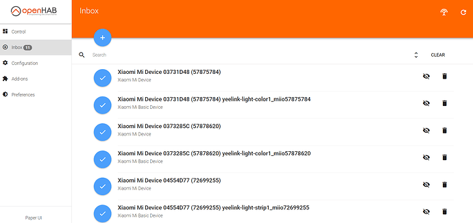

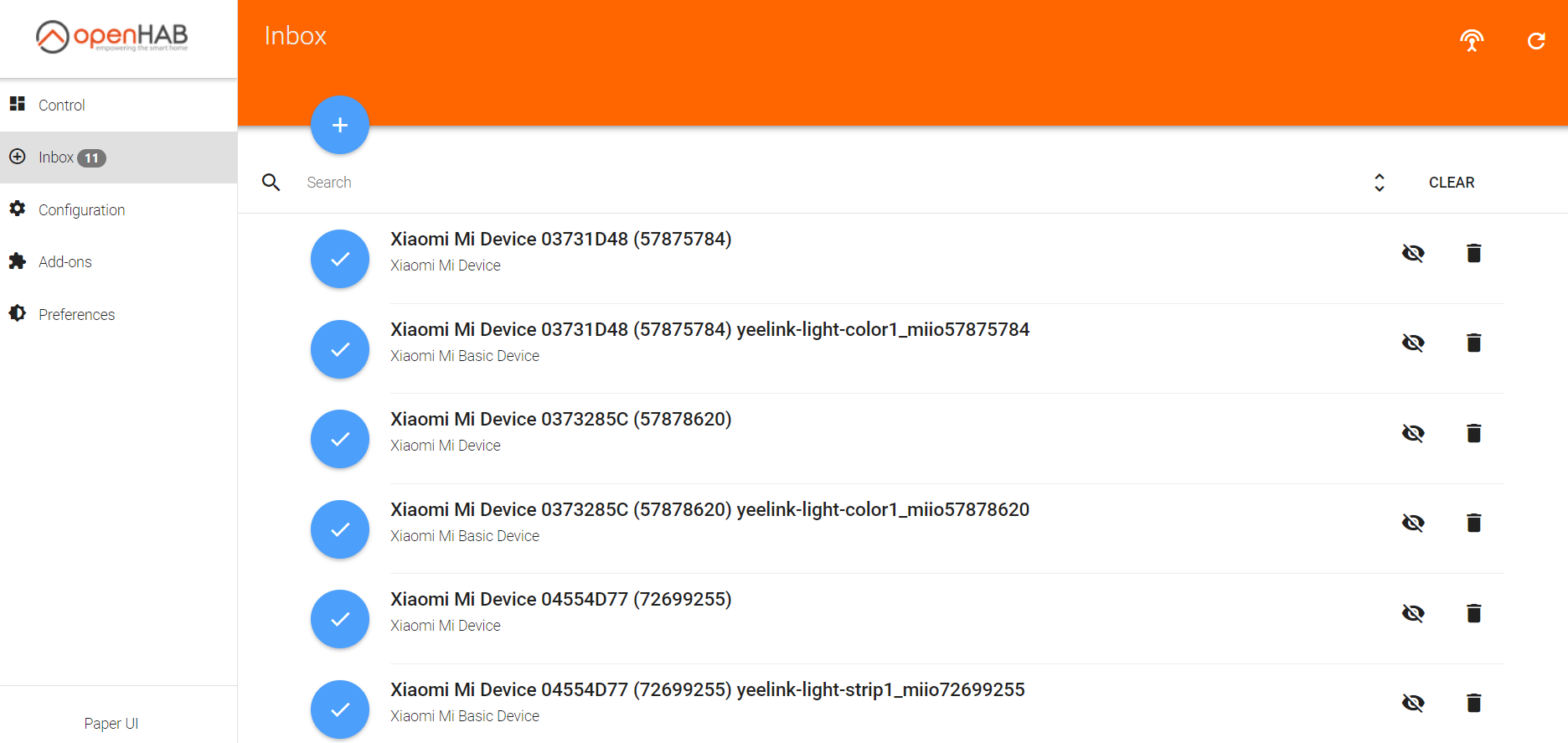

i upgraded to 2.4 stable .I installed the binding through paperui addons and in the inbox i get double entries!
i have 3 yeelight color bulbs and a ledstrip 1.0.As you see i get the same device as “xiaomi mi device” and as “xiaomi mi basic device”…Why is that?What device to add?I uninstalled the binding ,stoped openhab ,clean cache and restarted.I reinstalled the binding but i get the same double items…
wtr to the double entries: you can pick either one… end result is the same. The binding has 2 different types of discoveries. As the info provided by the device is not equal for the 2 methods, you get 2 items.
Unfortunately not all devices support both methods, otherwise one could be eliminated.
I did not find a good (supported by the framework) way to join them.
