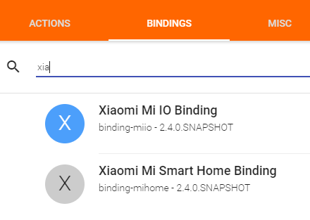

I somewhat prematurely removed the binding from the market assuming it would be available in all versions :worried:
To enable it now, either upgrade to the snapshot release or execute in the shell
bundle:install https://openhab.jfrog.io/openhab/online-repo-snapshot/2.4/org/openhab/binding/org.openhab.binding.miio/2.4.0-SNAPSHOT/org.openhab.binding.miio-2.4.0-SNAPSHOT.jar
Than bundle:list to find the bundle nr.
Than bundle:start nr where Mr is the number of the bundle… Probably the last/highest number
Sorry for the inconvenience
Thank you :slight_smile:
I was able to install the binding and it works perfectly.
Thanks again for your help.

Hi all, I’m not able to see this binding in Paper UI to install it. I have OpenHAB 2.3.0 and successfully installed the IoT Market Place and confgured it to show alpha versions of the bindings, but I only see di Xiaomi Mi Home binding. The page of the IoT market with the binding is also not reachable for manual installation. Do you know why?
hi Raffaello
you need to use the latest v2.4 milestone builds to access the binding now, as it’s no longer in the IoT marketplace.
