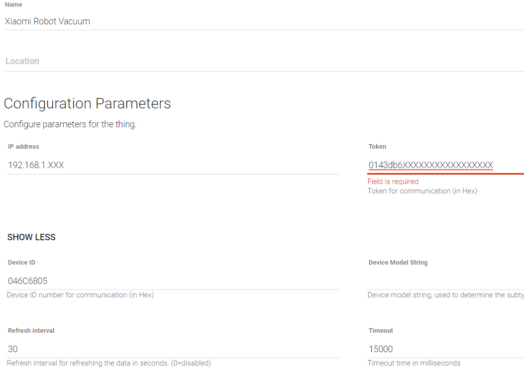

my Roborock v1 goes online and few minutes later it goes offline and stays offline !?
how can i fix that ?

Now:
Status: OFFLINE - CONFIGURATION_ERROR
@RiotMode this is a typical wrong token error…
The IP is right, but token not.
Use the hacked russian app to get the right token
thanks, but i dont have an android device here. only iphones, windows and mac.
i got the key out of the iPhone Backup
i used sqlite like in the post above, but maybe i am wrong there. i somewhere found a solution just with looking into the sql-file via TextEdit.app, but cant remember where. i see a lot in it, but i cant really spot the token, i somewhere found an explanation on how to get the token out of this text, but cant find it
EDIT:
OK i got it finally - thank you @marcel_verpaalen
