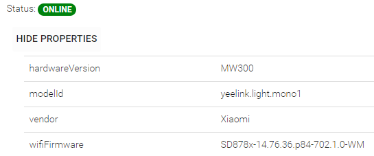

Hi!
I have two types of lamps, YLDP01YL(yeelink.light.mono1) and YLDP02YL(yeelink.light.color1).
The first lamp does not know how to change the color temperature, it is fixed at 4000K.
But in PAPERUI, I see a Color Temperature channel:
And in the log file:
2019-12-03 16:09:16.120 [TRACE] [nal.transport.MiIoAsyncCommunication] - Received response from 192.168.215.51: {"result":["on","63","0","","2"],"id":93}
2019-12-03 16:09:16.121 [TRACE] [nal.transport.MiIoAsyncCommunication] - Received  JSON message {"result":["on","63","0","","2"],"id":93}
2019-12-03 16:09:16.123 [TRACE] [nal.transport.MiIoAsyncCommunication] - inform listener org.openhab.binding.miio.internal.handler.MiIoBasicHandler@59cda6, data org.openhab.binding.miio.internal.MiIoSendCommand@e717301 from org.openhab.binding.miio.internal.MiIoSendCommand@e717301
2019-12-03 16:09:16.124 [DEBUG] [internal.handler.MiIoAbstractHandler] - Received response for white1 type: GET_PROPERTY, result: ["on","63","0","","2"], fullresponse: {"result":["on","63","0","","2"],"id":93}
2019-12-03 16:09:16.130 [DEBUG] [io.internal.handler.MiIoBasicHandler] - Error updating miio:basic:white1 property colorTemperature with '' : null
2019-12-03 16:09:16.131 [TRACE] [io.internal.handler.MiIoBasicHandler] - Property update error detail:
java.lang.NumberFormatException: null
	at java.math.BigDecimal.<init>(BigDecimal.java:596) ~[?:1.8.0_191]
	at java.math.BigDecimal.<init>(BigDecimal.java:383) ~[?:1.8.0_191]
	at java.math.BigDecimal.<init>(BigDecimal.java:806) ~[?:1.8.0_191]
	at com.google.gson.JsonPrimitive.getAsBigDecimal(JsonPrimitive.java:208) ~[bundleFile:?]
	at org.openhab.binding.miio.internal.handler.MiIoBasicHandler.updateProperties(MiIoBasicHandler.java:411) [bundleFile:?]
	at org.openhab.binding.miio.internal.handler.MiIoBasicHandler.onMessageReceived(MiIoBasicHandler.java:450) [bundleFile:?]
	at org.openhab.binding.miio.internal.transport.MiIoAsyncCommunication$MessageSenderThread.run(MiIoAsyncCommunication.java:226) [bundleFile:?]
2019-12-03 16:09:16.136 [TRACE] [nal.transport.MiIoAsyncCommunication] - Connection 192.168.215.51:39119
2019-12-03 16:09:16.141 [TRACE] [nal.transport.MiIoAsyncCommunication] - Message Details:Message:
Did I configure something wrong? Or should it be ignored?
There are also two channels:
Can they be used somehow?
When switching the first, no information (TRACE) about the change event of this channel is displayed in the log.
Thanks!
With the channel - Name, figured out:
YeeC_01_cmd.sendCommand("set_name [\"Color-01\"]")
@Olymp there are many yeelight, with slightly different commands. It can be that your’s is not supporting the property.
GET_PROPERTY, result: ["on","63","0","","2"], the parsing error can be handled more gracefully by the binding. Maybe you can add it to the github as issue. It is not a config error on your side. The lamp is responding with a “” and I think the binding is expecting a number there.
I think this specific color parameter is working for a white light, but only on specific modes. The binding is not switching on/off the color channels based on the selected mode, hence in the other modes you would still see this channel regardless that it does not do anything.
