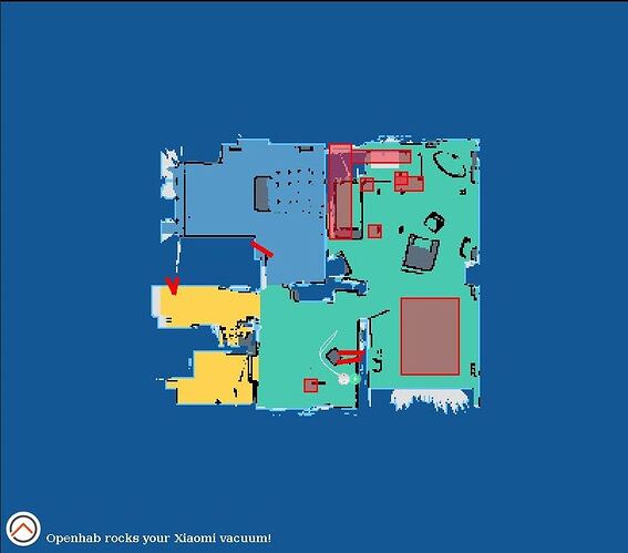

is there a way to make map bigger?At my 7" tablet i cant see anything… being longsighted cause i am an old guy ,doesnt help at all :slight_smile:
