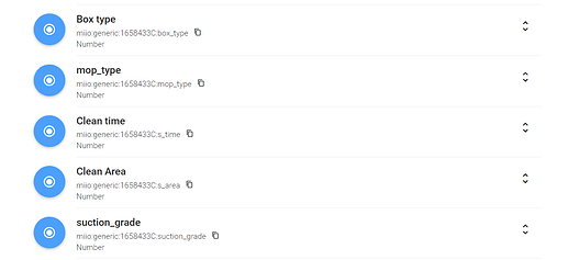

Hi Marcel.

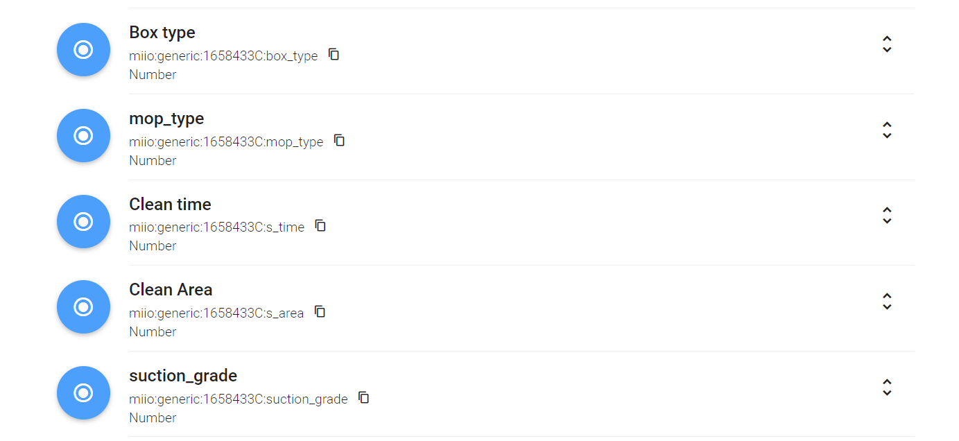

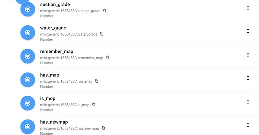

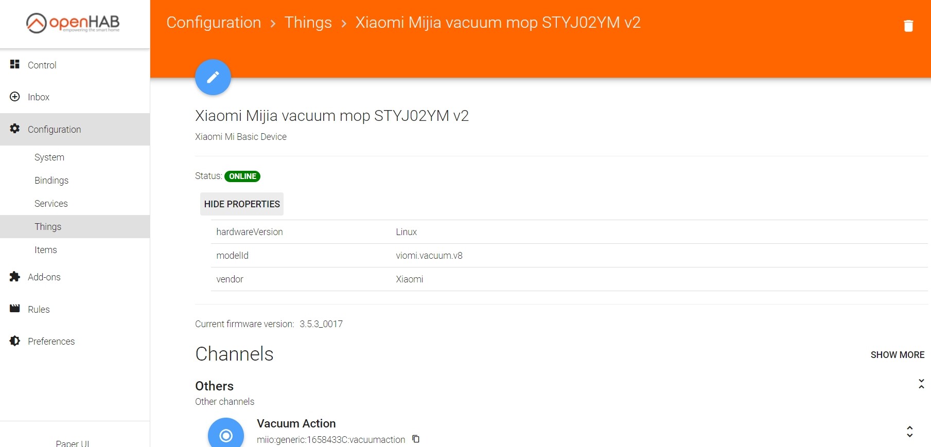

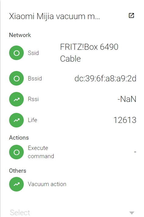

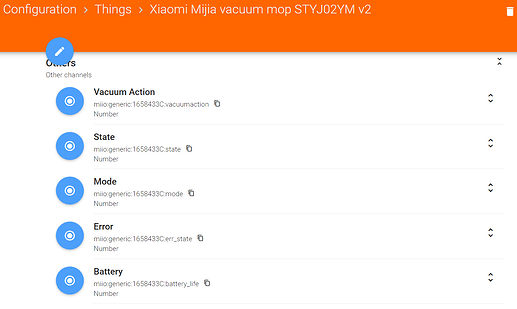

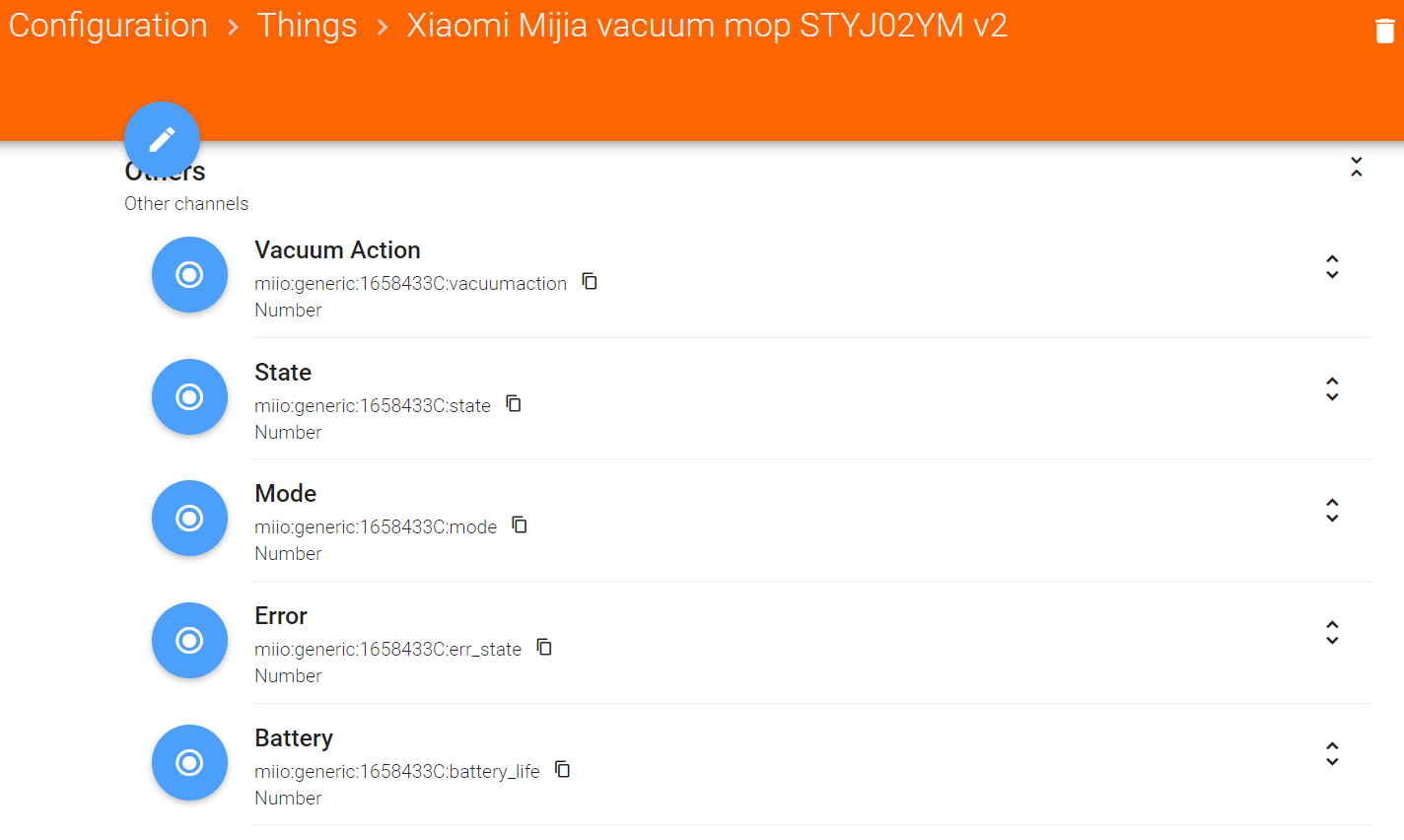

Yesterday they bring me for gift a Xiaomi Mi Mop Pro STYJ02YM . i am using your last version of binding. The binding found the model as you see in the photos.

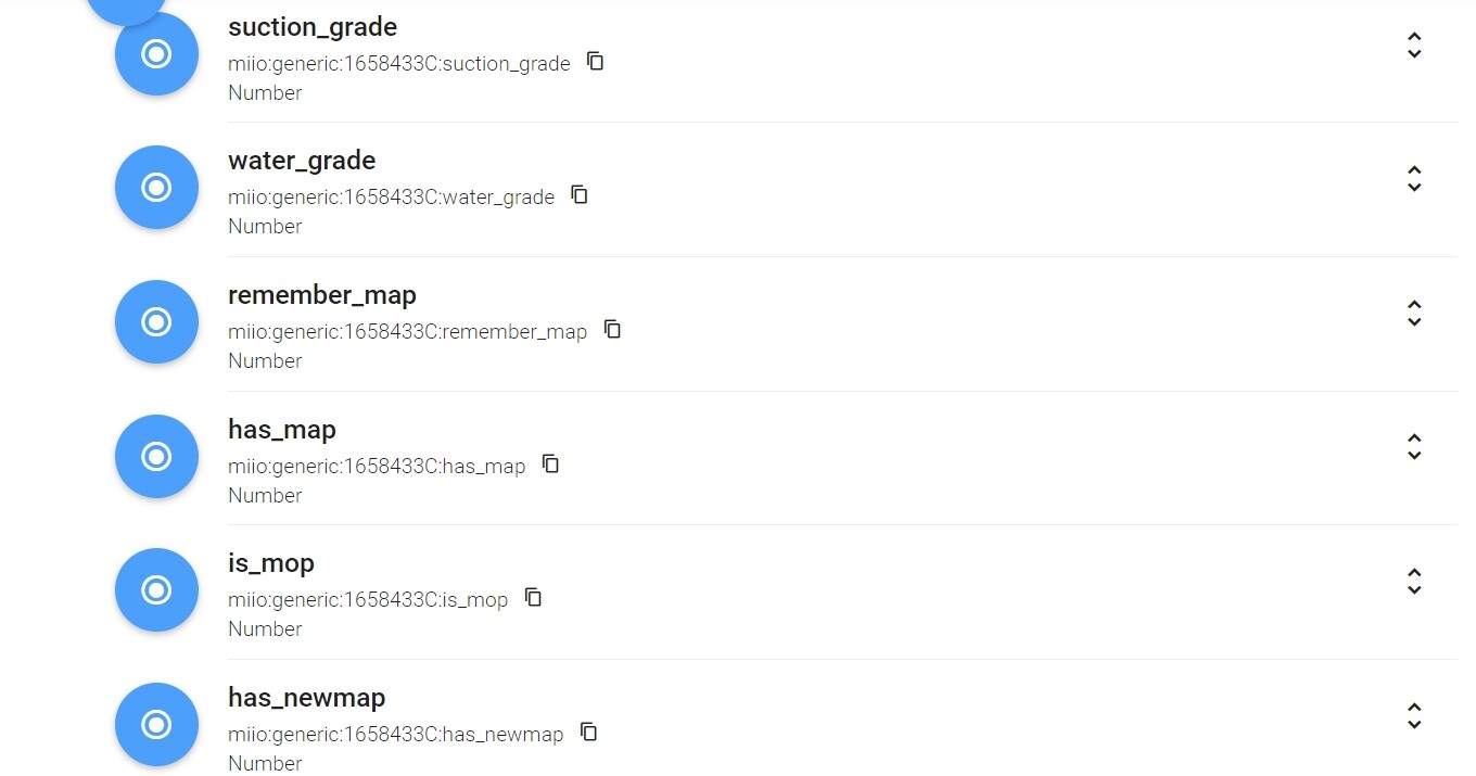

With the following channels
The problem is that i dont get values from all the channels , if you see in the battery i have only 1 and not the percent
Also i have a lot of errors in the log file.

Maybe your vacuum allows only 4 parameters to be retrieved at one time, or one of the parameters is not supported (normally this would respond with null)
Can you try in the command channel (advanced channel, click ‘show more’ to see it in paperUI) to execute
get_prop ["run_state","mode","err_state","battery_life"]
as well as get_prop ["box_type"]
if the first responds with 4 parameters and the 2nd gives a normal response we know the issue and can simply resolve it ( we need to add a line with "maxProperties": 4, to the database file openhab-addons/bundles/org.openhab.binding.miio/src/main/resources/database/viomi.vacuum.v8.json at main · openhab/openhab-addons · GitHub)
If the first does not respond with parameters, please try each property individually to see which one does not provide a response.
For the batter to show % prob we need to add a line "Channel Type" : "system.battery-level",
You could already download the db json file (above link) and make the modifications. see binding readme on where to save it.
Thanks for your fast respond.
when i give the first command i get back this : {“result”:[5,0,2105],“id”:10264}
the first command give this : {“result”:[1],“id”:10268}
what does that mean for me now :slight_smile:
How to proceed below???
Sorry but i need your guidance.
Thanks a lot
Nikos
as you only got 3 items in your result, one of the 4 properties is not working well.
To find out which one, can you try each of them separately
get_prop ["run_state""]
get_prop ["mode""]
get_prop ["err_state"]
get_prop ["battery_life"]
I expect one of these to fail… that property is not supported by your device than and we need to remove the channel for it
ok these are the results i think that the battery_life its not working??
i think i found the error why i dont get the battery_life back. If i type
get_prop [“battery_life”] return nothing but if i type get_prop [“battary_life”] then i get the value from the battery. so its a typo on the word battery to battary. How can we correct this?? only with the json file??
Can you once more to try to run the get_prop ["run_state","mode","err_state","battary_life", "box_type" ] to confirm indeed 5 properties in one go works fine?
To fix it now, that would require you to download the json file from the link in my earlier post and make make the change the property.
now it give me back 5 properties. {“result”:[5,0,2105,100,1],“id”:47}
i have edit the json file like this
“property”: “battary_life”,
“friendlyName”: “Battery level”,
“channel”: “battary_life”,
“type”: “Number”,
“refresh”: true,
“actions”: [
but then the binding couldn’t recognise the Device Model String i ahve edit manual viomi.vacuum.v8 and now its looking all correct. i will test it more and i will inform you if something its not working. one last thing how to get the maps?? i dont see any map file in my openhab files?
Nikos
Okay, great…
wrt to the device model string, and the firware & manufacturer… Ive seen with other devices as well that those don’t work. I have already removed them in the official 2.5.9
To test if the map commands work, can you try to delete the thing, and than manually add it as a miio:vacuum thing. Non of the channels will work but the big question will be… does the map channel work? If yes, than it needs bit of work but than we know.
