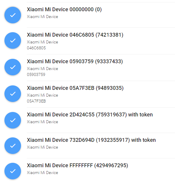

is there an easy way to find out what those exactly are ?
my roborock is already in OH
Check your order history.
You made my day :slight_smile: LOL..
Add them to OH and you see… if you really dont wanna… check the file in userdata/miio with the tokens..in there is also a friendly name of the device
