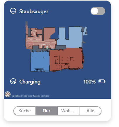

Hi Marcel,
wouldn’t it be possible to set the background to transparent?
If so, it would probably please all and fit everybodies need…
For now, I had to work around the given shape and color and ended with
Would be a lot easier to integrate the image without the blue background (and cropped to the “used” area only).
Sorry, if “transparent color” has already discussed (and answered) somewhere already :wink:
Nah, that has not been discussed earlier. (cropped yes, but as this graphics programming is not really my area of expertise I did not dive into that yet)
Might be a good idea indeed. Would be great if you could try it out and make a PR :slight_smile:
