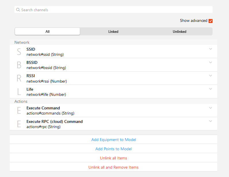

I hope that is right. The documentation is not totally clear for me sorry. Debug log is a log what i don’t know. I know only openhab.log. I get a new device after reboot i thing.
But i don’t get any channel. I switch over to cloud in thing settings. But i have only hidden channels:
To enable debug logging, you can type in the console log:set debug org.openhab.binding.miio
The right folder is printed during the startup of the binding.
You may need to restart OH if the path was not existant when OH was started.
In the log you should see something like using etc\openhab\misc\miio\dreame.vacuum.mc1808-miot.json see Xiaomi Mi Air Purifier (Xiaomi Mi IO) - #330 by chrismast for a screenshot of how it would loook like.
After you’ve added your thing, it may take 1 to 2 minutes to communicate with the device and initialize the thing in the right way.

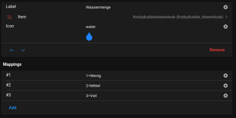

i restart openhab and nothing happends. I switch debug mode on and restart only the binding. Now WaterMode is there. Thank you very much! Sometimes openhab is a little bit silly…
I create selection via Sitemap but there is no effect if i choose something:
But read out of item works.
