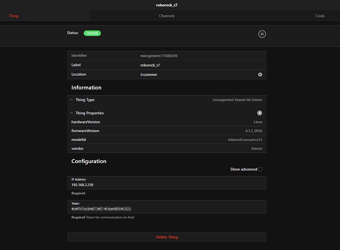

Hello everybody,
my name is Dennis and i started my openhab project a few weeks ago. Last week i got a Roborock s7 and want to add it in my smart home too.
Currently i have the problem to connect my “Robby”. The thing type is: Unsupported Xiaomi Mi Device", the modelId is “roborock.vacuum.a15”. The token seems correct because it is “Online” (i got the token from GitHub - PiotrMachowski/Xiaomi-cloud-tokens-extractor: This tool retrieves tokens for all devices connected to Xiaomi cloud and encryption keys for BLE devices.)
. My thing settings are here:
Under channels i get these:
String   RoborockS7NetworkSsid           "Ssid"                                                    {channel="miio:generic:1750DD59:network#ssid"}
String   RoborockS7NetworkBssid          "Bssid"                                                   {channel="miio:generic:1750DD59:network#bssid"}
Number   RoborockS7NetworkRssi           "Rssi"                                                    {channel="miio:generic:1750DD59:network#rssi"}
Number   RoborockS7NetworkLife           "Life"                                                    {channel="miio:generic:1750DD59:network#life"}
Switch   RoborockS7ActionsPower          "Power on/off"                                            {channel="miio:generic:1750DD59:actions#power"}
String   RoborockS7ActionsCommands       "Execute command"                                         {channel="miio:generic:1750DD59:actions#commands"}
String   RoborockS7ActionsRpc            "Execute rpc (cloud) command"                             {channel="miio:generic:1750DD59:actions#rpc"}
Switch   RoborockS7ActionsTestcommands   "(experimental)execute test to find supported channels"   {channel="miio:generic:1750DD59:actions#testcommands"}
I created a sitemap just for start and stopping. The log give me this for the start:
2021-04-05 15:04:14.729 [INFO ] [openhab.event.ItemCommandEvent      ] - Item 'RoborockS7ActionsPower' received command ON
2021-04-05 15:04:14.731 [INFO ] [penhab.event.ItemStatePredictedEvent] - Item 'RoborockS7ActionsPower' predicted to become ON
2021-04-05 15:04:14.740 [INFO ] [openhab.event.ItemStateChangedEvent ] - Item 'RoborockS7ActionsPower' changed from OFF to ON
and for stop:
2021-04-05 15:04:24.615 [INFO ] [openhab.event.ItemCommandEvent      ] - Item 'RoborockS7ActionsPower' received command OFF
2021-04-05 15:04:24.618 [INFO ] [penhab.event.ItemStatePredictedEvent] - Item 'RoborockS7ActionsPower' predicted to become OFF
2021-04-05 15:04:24.623 [INFO ] [openhab.event.ItemStateChangedEvent ] - Item 'RoborockS7ActionsPower' changed from ON to OFF
and also
2021-04-05 15:04:24.631 [DEBUG] [nal.transport.MiIoAsyncCommunication] - Command added to Queue {"id":125,"method":"set_power","params":["off"]} -> 192.168.2.230 (Device: 1750DD59 token: 464F767AXXXXXXXXXXXXXXXX69543535 Queue: 1).
But nothing happens. Any ideas? Do I make a newbie mistake?
I am very happy if you guys could help me.
Dennis

I have the same problem. The Roborock ist online and I get only a bit of Roborock S7 Channels. The Roborock does not respond to commands.
The log file says “Discovered from cloud, but ignored because not supported: 1751250E Device name: ‘Robo’, did: ‘391193870’, token: ‘434d594b7111185a6f6379745a377442’, ip: 192.168.178.59, server: de”
Yes, indeed your vacuum is not yet supported so your milage may vary.
The discovery can be worked around with setting the binding config to accept these
Than you can try the trick of overriding the model
Anyway, suggest to add a github issue with the debug responses for this robot so it can maybe be supported in a future release.

I opened an issue containing the debug info for the new S7 model as requested: [miio] Add support for Roborock S7 vacuum robots · Issue #10590 · openhab/openhab-addons · GitHub.
Did you try if it works is you override the model with one of the known models?
e.g. put rockrobo.vacuum.s6 in the config as model.
Can you try and feedback the debug log

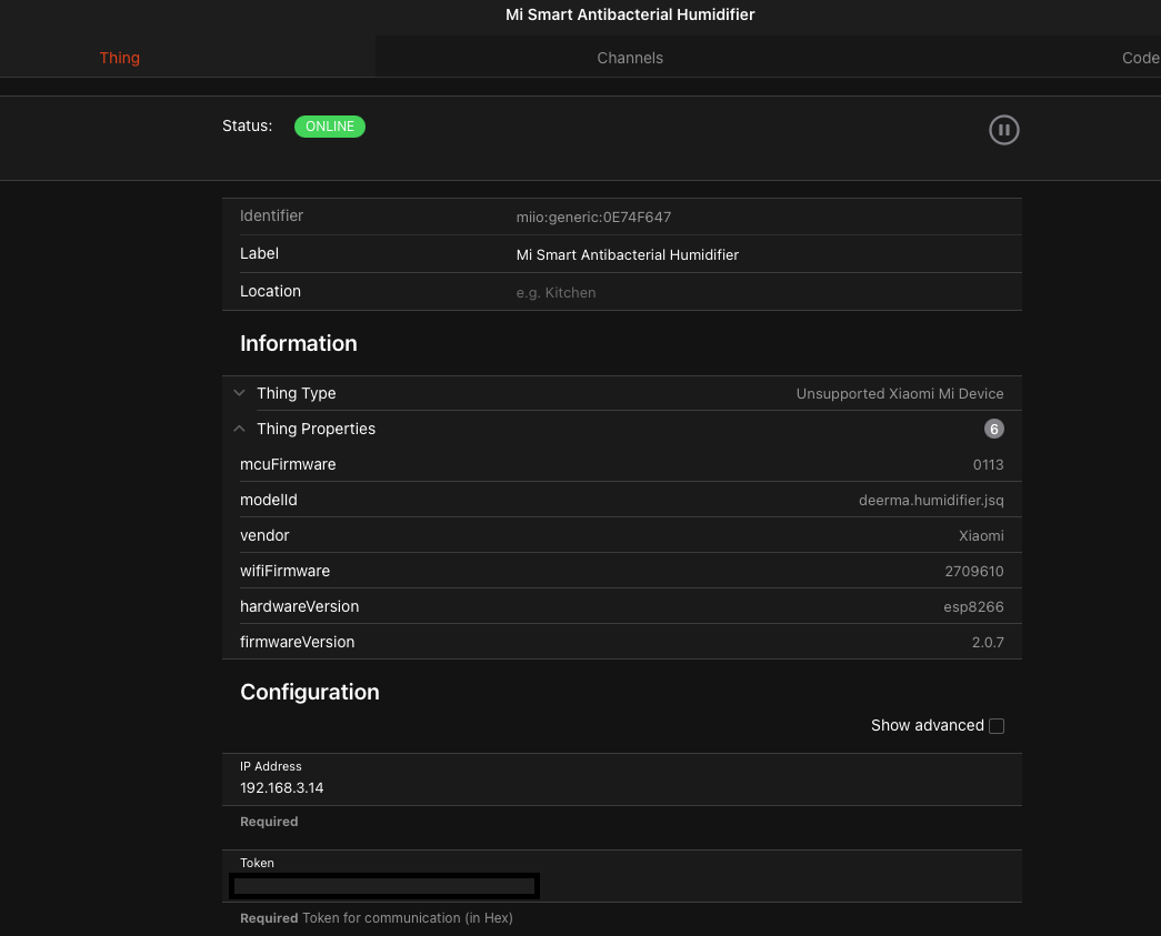

first Thanks for this great Plugin :slight_smile: .
I am new to Openhab 3, i installed this Binding and I have 3 Mi Devices:
Roborock S5 - works perfect
Mi Air Purifier 2 - works but only in cloud mode (but everthing works), in Direct Mode its always offline

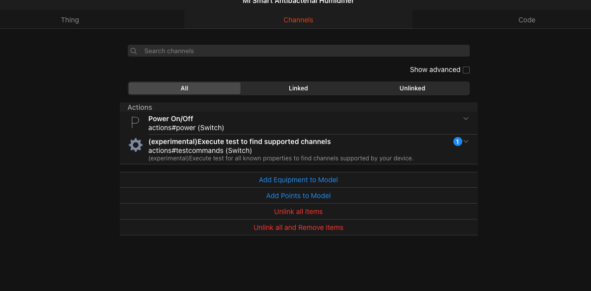

Mi Smart Antibacterial Humidifier - this device also only “come online” in cloud mode and after 1 Minute it is online and shows Information under Thing Properties.
But there are “no channels” and the Power channel did not work.
Is there a way i can add the channels manually ? The Binding “wiki” say it is a deerma.humidifier.jsq1 and it have support.
This device was only added quite recently. (end feb), so make sure you have the snapshot or 3.1-M3 / M4 version for this device to work
Thank you, i updated to M4 and now it works perfect :slight_smile: .
One question, in the Original Mi App the device Shows the Temperature, is there a way to see the temperature with this binding?
you can try to enable the (advanced, use unhide in channel page) command channel. Also set logging to debug. see binding readme for more elaborative explaination
and try e.g. get_prop [ "temperature"] or get_prop [ "Temperature_Value"] see if it responds with the temperature you see in the app. Let me know the result and we can incorporate it maybe
