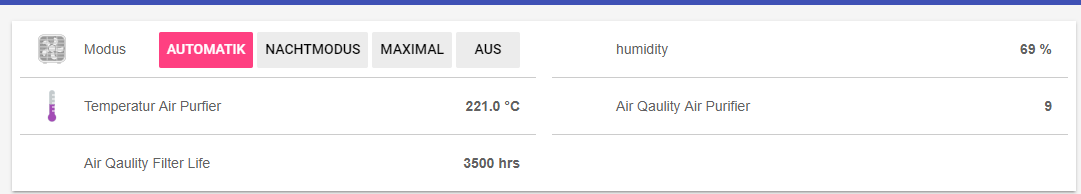

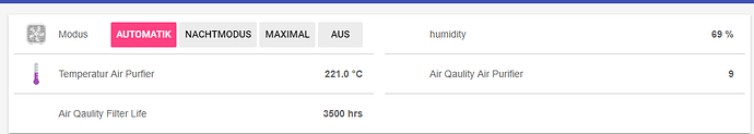

@shorty707
Looks like it is 10x as big indeed, correct?
Currently I don’t do any calculations, just give whatever the output from the device is.
Can you send me the request & response to the ‘get_prop’ command. See if somehow the value is getting wrongly interpreted.
correct - in the above screenshot it should be 22,5 C; in the below one 22,1 C

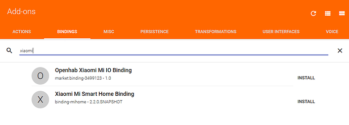

@marcel_verpaalen, I just received my vacuum cleaner and am eager to install your binding. But unfortunately I cannot find it in the bindings list. Do you have any idea, what I’m doing wrong?
You need to put a setting to allow for beta software in the market place settings. I had same issue, after setting this it appears.
Verstuurd vanaf mijn iPad
It is the first in your list. Mi IO binding.
I renamed it once it supported other devices as well

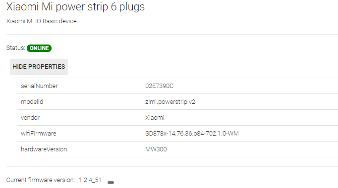

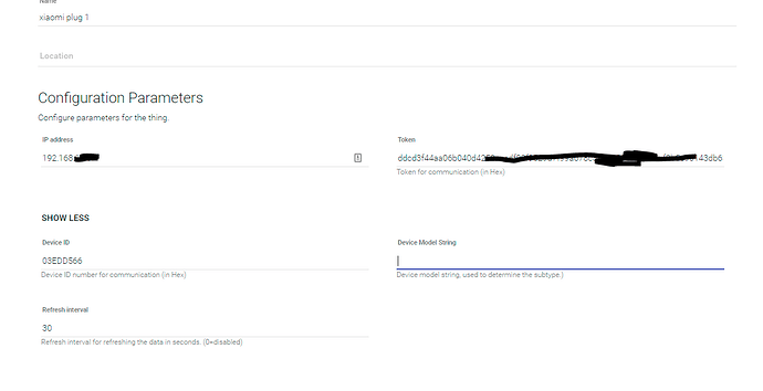

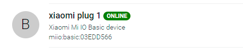

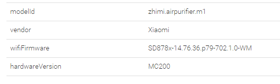

I have a xiaomi original WIFI smart plug - it has been detected as a basic device
however a couple of questions:
How do I find out the device model string as there is only a command channel at the moment.
If this is the only option - what do I send it to just do a on or off?
@Andrew_Pawelski
When you enter a valid token, the model will be populated automatically. No need to manually put in anything. I assume the switch you currently see also does not function, correct? (If it does, and the model is not populating, pls send me a full log, from the start of the binding until approx 2min after)
From the lengthy key, am I correct to assume it is a key extracted from ios? If yes, please check if you see a ‘could not decrypt key’ in the log, as that would explain the issue
btw. For your plug, better post your questions in this thread.
@marcel_verpaalen is the information from above post sufficient?
let me know when I can provide morr

Can you tell me what are the exact strings you send for the various modes. I’m not sure I have them all
Can you pls indicate your exact model + fw, as I had the filter stuff in an earlier version, but than few did get null responses. (each version seems to have different subset of commands, maybe even firmware related)
