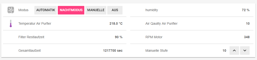

all added channels work…
some comments…
  • miio:basic:035CAFE2:filterusedhours → in raw data this is seconds currently; it reports the same value for a longer time… and internally seems to be updated in periodic cycles when division by 3600 is ,25 ,5 ,75 or a full decimal…
    however in my case the value matches neither the run time of the device, of the filter or anything… so not sure what it actually is

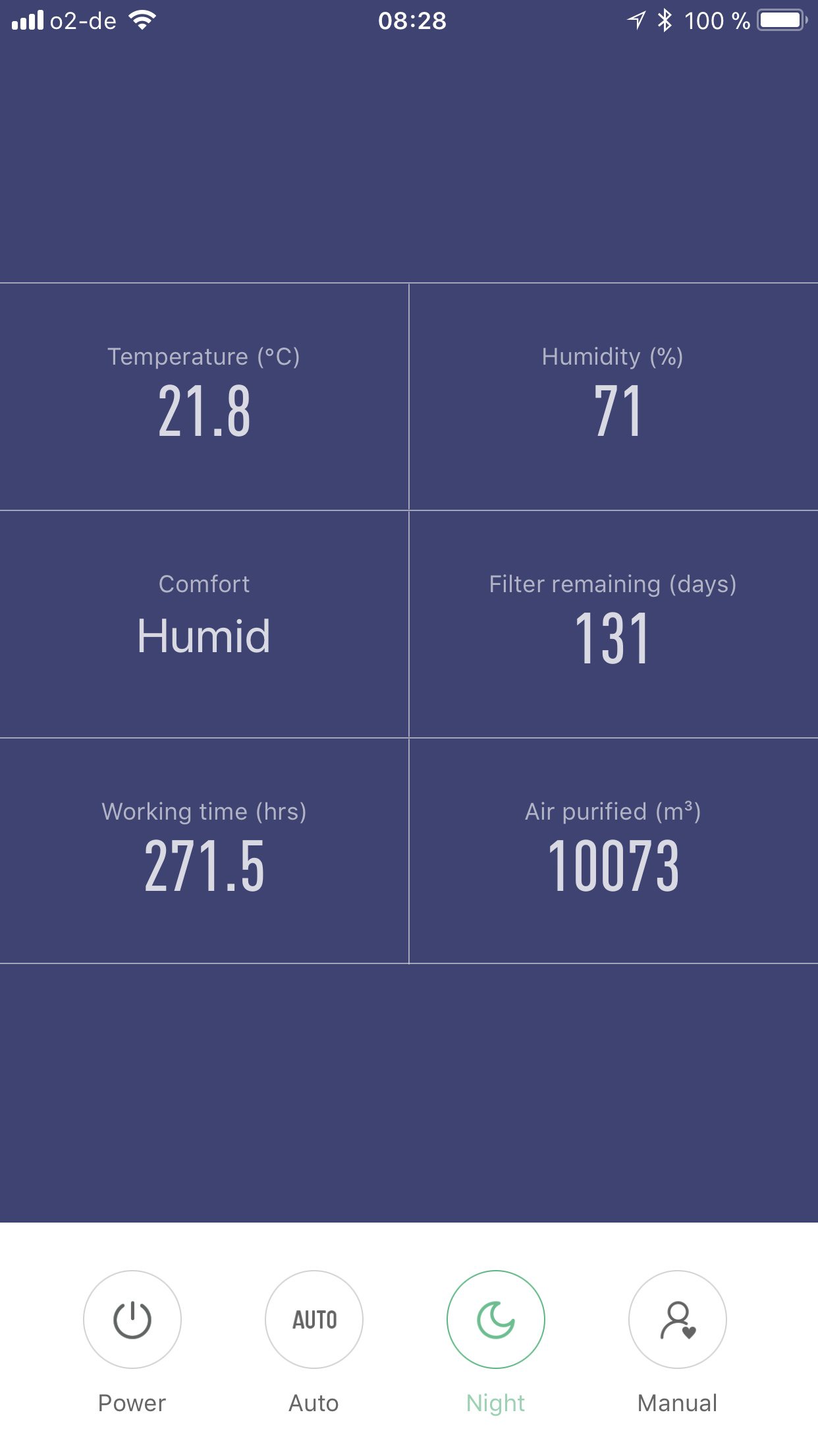

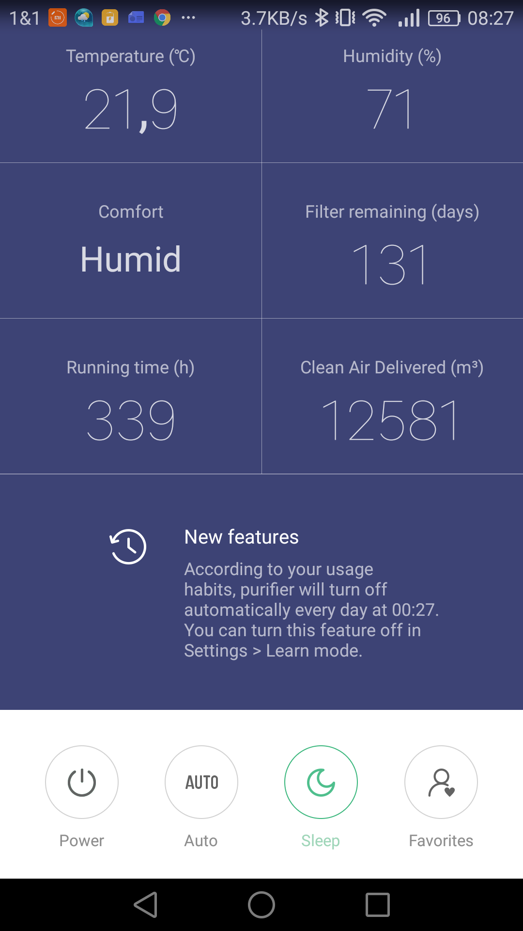

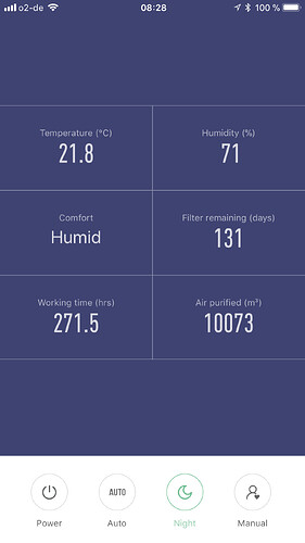

update to this channel again… it seems to be the RUN TIME of the device itself in seconds..
I was confused before because the iOS version says something different… see below the screenshots of
iOS compared to ANdroid; (iOS needs to fully stop and restart the app to pull the correct value)
→ Run Time vs Working Time
→ air purified (seems to be runtime * 37; ignoring any fan speed setting :wink: )

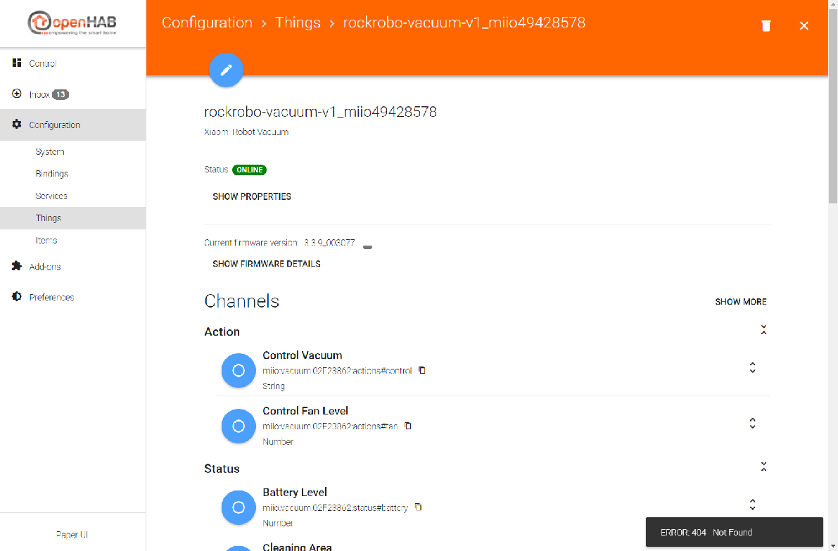

When I click in any miio thing, I got an Error: 404 - NOT FOUND. Any Idea what happen?

Thank you. I didn’t know it was just updated. The latest version worked for v6, and database entry error gone. But I still got the error 404, but I can’t find anything related in the log. I will post a screenshot.
Can it be that your oh version is bit older.
I used to have the same, but after some oh update it went away. I think it had to do with the firmware version feature. (as for me it started when the binding provided the firmware version no.)
