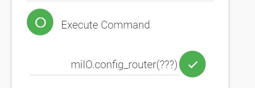

Thank you very much for this project. I can’t seem to get my setup working, however.
I’m trying to setup my Xiaomi Mi Vacuum with Openhab running on my PC. I do not want the vacuum cleaner to talk to the outside world. I do not need the app to function. You mentioned a couple of posts up that I should therefore do the following:
  • Reset wifi
  • Connect to the Xiaomi hotspot with Openhab
  • Do a discovery (the token will automatically be captured)
  • Finalize the WiFi setup using the miIO.config_router command.
All steps succeed, except for the last one, probably because I do not know the correct syntax. So the robot is discovered, an I am able to send commands:
I tried a couple of syntaxes, e.g. miIO.config_router({"ssid":"WInternal","passwd":"xxx"}), however I can’t get it to work. Here you mention that the wifi password’s transmission is not following JSON standards, however I can’t seem to figure out what is the standard syntax I should follow.

I seemed to have more luck with miIO.config_router{“tz”:“Europe/Brussels”,“gmt_offset”:0,“ssid”:“WInternal”,“passwd”:“xxx”}
This was inspired on the perl code found here: Xiaomi WiFi Devices Modul (Vacuum/Airpurifier/Fan) - 72_XiaomiDevice (Support)
=> this gave [OK] and then the robo hotspot disappeared and I saw that it connected to the network. However, I cannot get my cleaner to work then, so it seems there is another part of the pairing which is lacking..
Any idea how to proceed?

I think indeed that changed with the latest firmware which has the timezone information in it (specifically used for the timing of the automatic cleaning schedule). Older firmware versions did not require this.
What is important to know that once you change it, it won’t work anymore via the Mi Home app. The app is not connecting anymore. Next thing you need to get is the new IP address. Best thing is to note your token, and remove your thing again so it can be discovered again on your regular network. Alternatively you can try to see on your DHCP server (e.g. for most folks your wifi router) if the vacuum is connected and what is the new IP.
Is your vacuum on the new network & discovered again?
What is the error you encounter? (timeouts on commands, or no pings?)

Ok, so the ‘WInternal’ network is a network which could not communicate with the outside world. It seems that is part of the problem. I opened it up, did the WiFi reset again, issued the command miIO.config_router{“tz”:“Europe/Brussels”,“gmt_offset”:0,“ssid”:“WInternal”,“passwd”:“xxx”}, and it appeared on the WInternal network as ‘rockrobo’.
Then, I manually added this with the new IP and the same token as a new vacuum cleaner in OpenHab, At first it showed online, but sooned turned to offline with ‘configuration_error’. Can I debug this further?
Perhaps it’s just not possible anymore to do this without the app, as in reply 2 on this forum Xiaomi WiFi Devices Modul (Vacuum/Airpurifier/Fan) - 72_XiaomiDevice (Support) that possibility has been striked through. However, the wifi pairing succeeds, it’s just after the pairing that I seem to have lost the control.
Your ‘’ At first it showed online, but sooned turned to offline with ‘configuration_error’." indicates a token problem.
This maybe has to do that with the latest firmware (3.3.9_003077) the token is changing after the connection with mi cloud.
Earlier versions this did not happen. I’ve currently connected my miio philips led bulbs in the same way you described, these remain working,
So, just a though:
What happens if you temporary open your WInternal network to the internet. Connect with the mi home app your device to the WInternal network. Once connected (and you can read your new token from the mi app) you disable access to the internet for the WInternal network.
I think I tried that before, but I had problems as well. Perhaps I should try that again.
Anyway, if there is a token error, shouldn’t it give a debug error that decryption failed or something? It just says there is no response.
[DEBUG] [ing.miio.handler.MiIoAbstractHandler] - Received response for ece705f4 type: MIIO_INFO, result: null, fullresponse: {"error":"No Response"}
Unfortunately the robot just gives no response on a token error. Hence the more recent versions of the binding change the status to configuration error if for several times the device is pingable, but no response to commands.
The communication between the vacuum & the cloud is still not deciphered. (not many folks attempted it either)
Once that is logged & understood the changing of the token is maybe controllable.
The only hint I have is that the token is not fully random, but has the time element in it.
Meaning it is some fixed secret + time (probably the first time the token is requested) offset.
