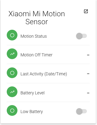

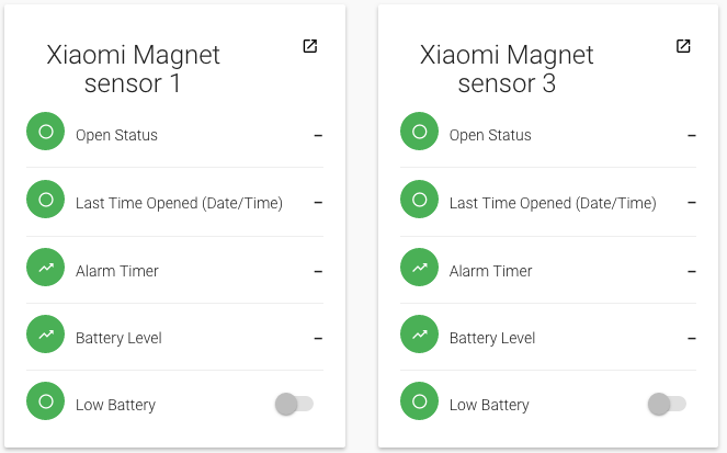

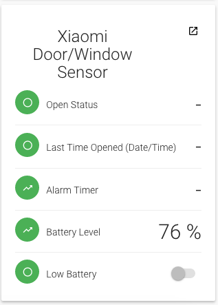

but only for 2 things. All other sensor in inbox!? but why?
if i linking any of sensor, i se no any information in thing

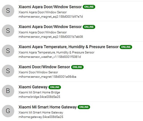

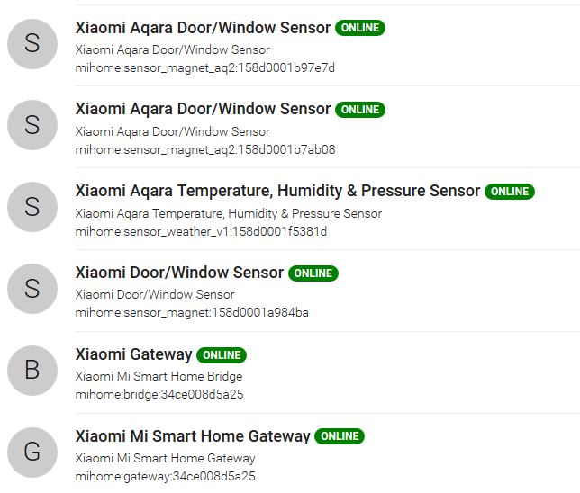

Autodiscovered gateway and sensors look like this, maybe you can adapt those to your manual things config:

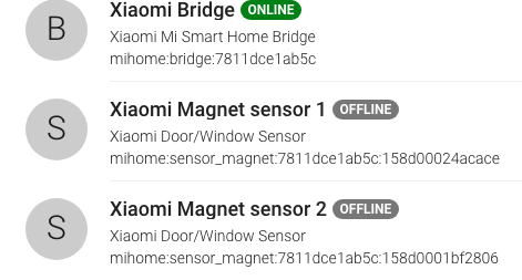

some time it’s online, some time later
I have the impression that the specified port for binding 9898 is busy with something else

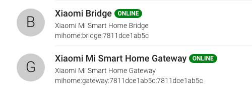

xiaomi home bridge does not appear in the inbox. if you manually add the xiaomi home bridge only then the sensors start to appear in the inbox, without xiaomi gateway. but after a while they become offline.
