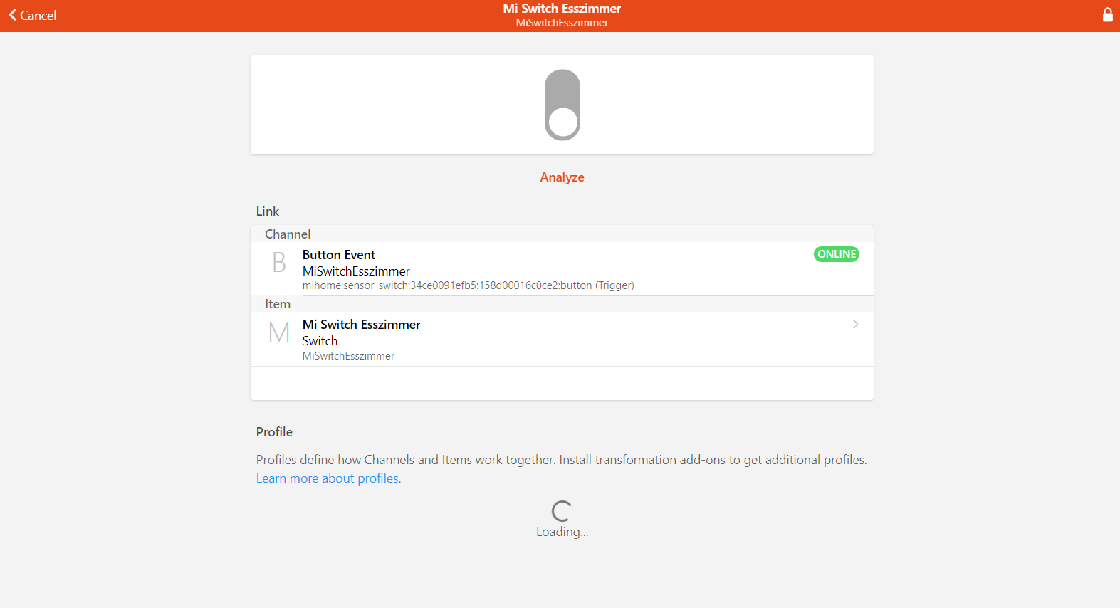

I can create an Item and Link this to the button channel of the switch.
When I open the Item and click on the button-event channel I see the link between Item and Channel (Button Event). Furthermore I see a profile section, with a link to the documentation. But I see no profiles available or the possibility to enter a profile. Instead I just see a message “loading” which does not terminate. See attached screenshot.

Not necessarily. A Profile is a way to intercept and change an event coming from a Channel and modifying it in some way before it gets to the Item. Profiles only exist on the Link between a Channel and an Item.
Here you have an Event Channel. There is no Link and therefore no where to apply the Profile. Furthermore, you want to do more than just change the event from “SHORT_PRESSED” to something else, you want to do some <ACTION>.
So a rule really is the only thing to use here.
That doesn’t address why you are seeing the problem showing the profiles in MainUI. I suspect it might have to do with the fact that it’s an Event Channel and Event Channels cannot be linked to Items.
