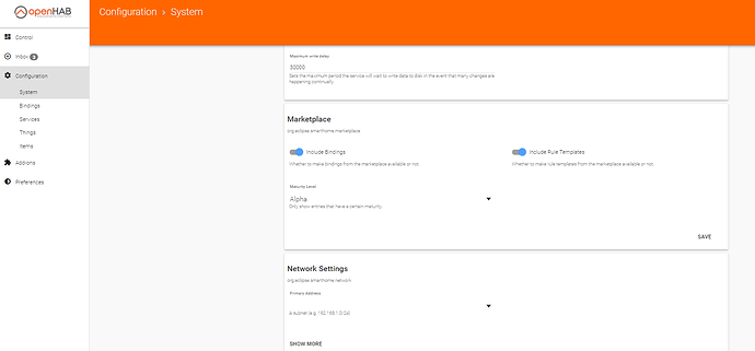

you properbly need to enable beta binding i you system configuration, then you can see it.
Can I enable it via Paper UI? help :frowning:
Here :slight_smile:
I think you also have to enable LAN mode, see: Cannot find the developer mode for Yeelight white bulb - #14 by t.delahera - YEELIGHT LED Bulb (White) - Yeelight Forum
Thank you!
But I don’t have a marketplace @ Configuration > System ..
I think there a binding for marketplace
Yeah, found it already! Thanks a lot!
