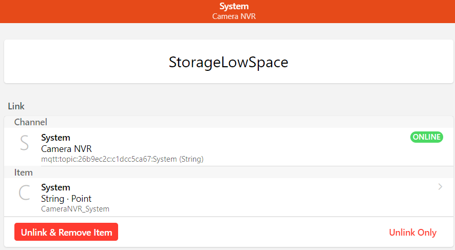

Keepin the StoageLowSpace event, you should see an item linked to the system channel promptly update to StorageLowSpace after creation:
Similar, your other channels and items update f.e. to HumanDetect. You then may create rules to make your smart home self-defend :wink:
