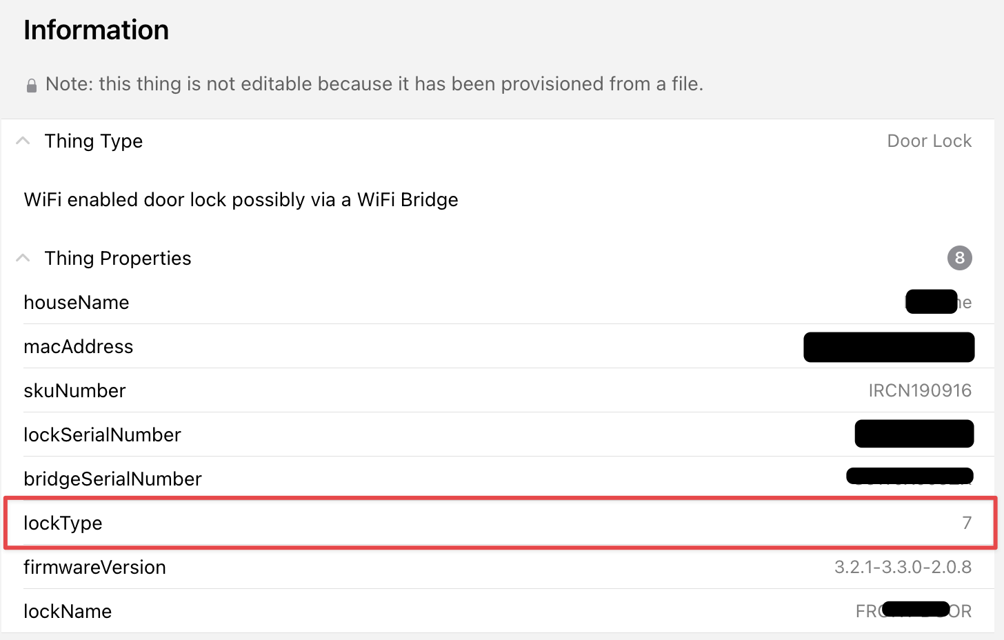

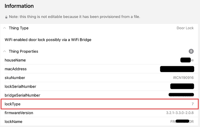

I need your help!
The API is undocumented and development is based on analysing 3rd party SDKs and trial/error.
I’m trying to decode the lockType parameter - if it cannot decode please post to the forum which lock you have. You find this information in the thing properties.

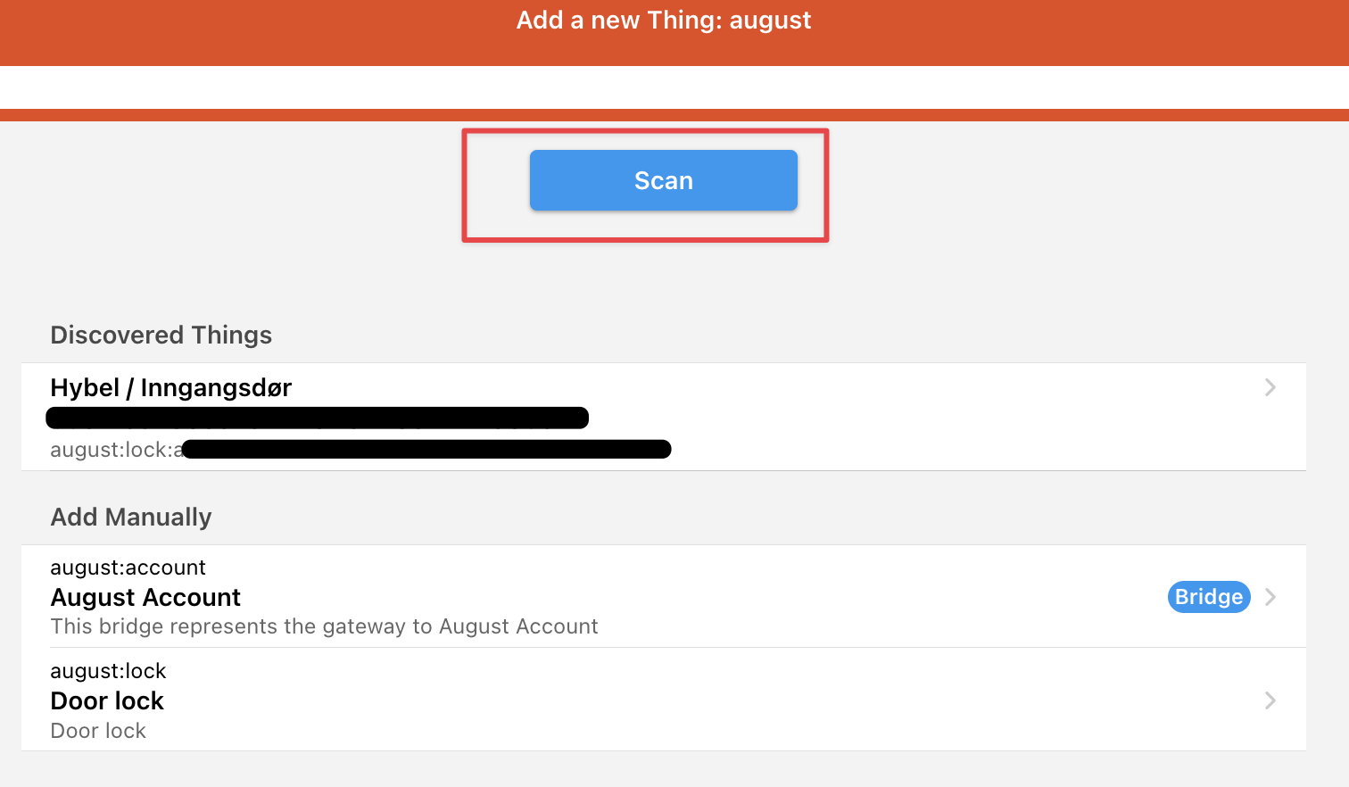

I am giving this a try this evening and I’m having trouble figuring out how to get the lockid. I’ve added the bridge and updated with the validation code from email. I can see from the openhab.log that it has logged in to the August account and has found the correct number of locks, but what do I do from there to find the lockid for each lock (i.e, how do I find the bridge to see the locks it has discovered)?
Thanks,
Jeff
I ended up using the Rest API to trigger a discovery for the binding, then my locks showed up in my Inbox and I was able to add things for them. Getting it all setup with items now, so I’ll report back if I encounter any other issues. Thanks!

After adding a bridge, the regular discovery should find them if you push the “Scan” button?
