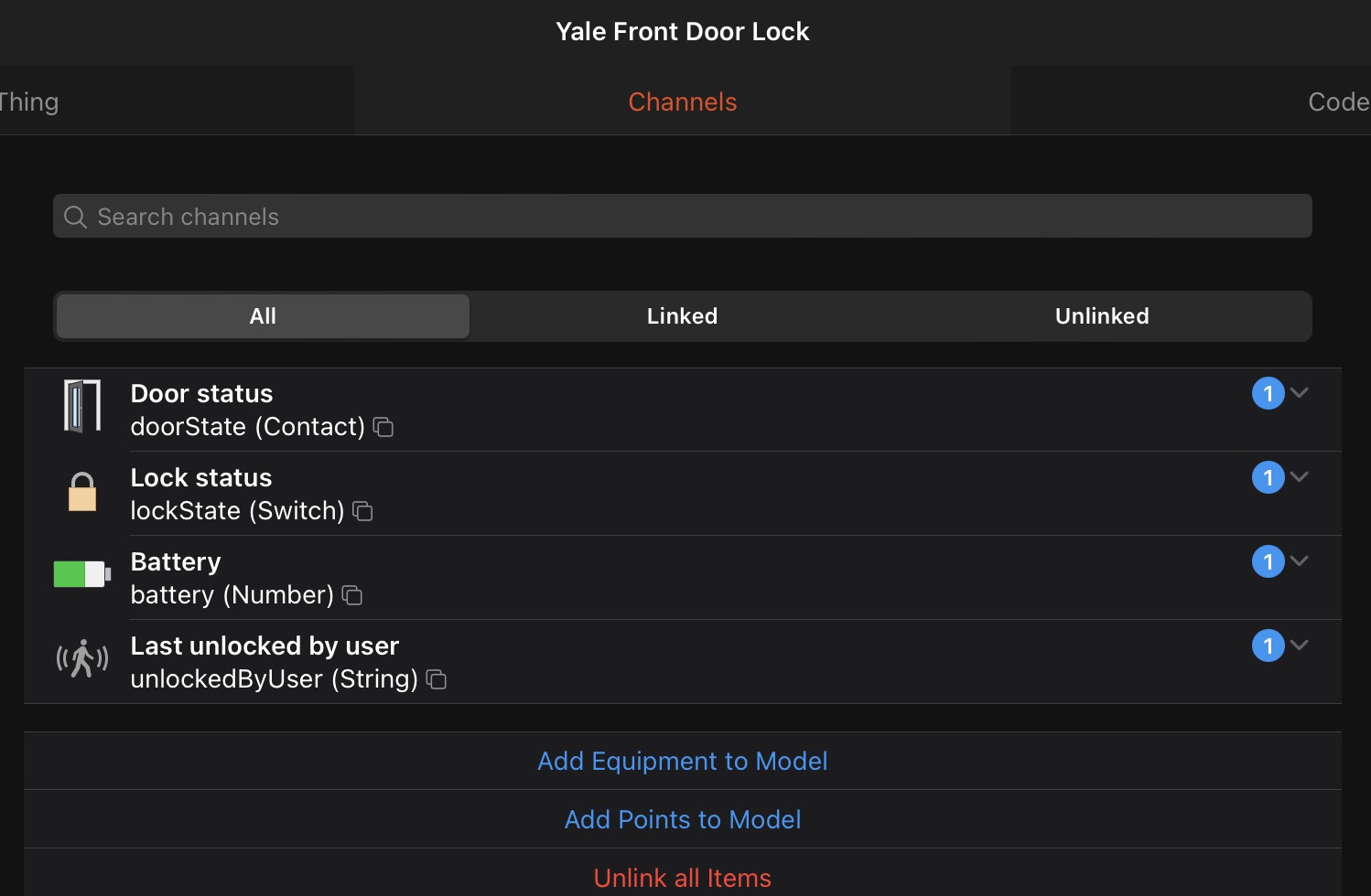

To provide more background information, I use the keypad to lock and unlock the lock. The lock is almost instantly locked or unlocked; however, it can pass many minutes before something is notified to OH. I have seen cases where even the status isn’t updated after hours (even though the refreshInterval is set to 3600 secs.) and it is updated once I load the Yale Home app.
I’m not sure if the issues is the connection between the lock and the bridge, or from the bridge to OH. The bridge is less than 1 meter away from the lock, although there is a wall in between. I’ve placed the bridge in the second nearest plug, which is located a little more than 2 meters away but not within line of sight.

@seime, I downloaded and installed the latest version but it can’t connect to the bridge.
I can see the following message, but I don’t know if it’s related

I’ve downloaded and installed the latest version of the binding ( Release Latest Build · seime/openhab-august · GitHub) but don’t see any new channels on the lock thing. Is there anything I need to do to make them appear?
I just installed the newest binding (4.1.0.202312020842).
Indeed, the UI doesn’t show the new channel:
I use file configuration and I manually set up the item and connected it to the channel (batteryKeypad), yet the value is NULL.

@mri_ice @nelson.aponte Hmm that is strange. It shows on my setup, but I have not used any of the new thing upgrade mechanisms - just added the channel. Try to (in given order from less intrusive to intrusive)
  • enable/disable bridge + thing
  • restart openhab
  • modify thing file
I have noticed that OH still does not always detect changes in thing files, but I have not had the time to try to pinpoint the issue.
Let me know if it doesn’t work out
