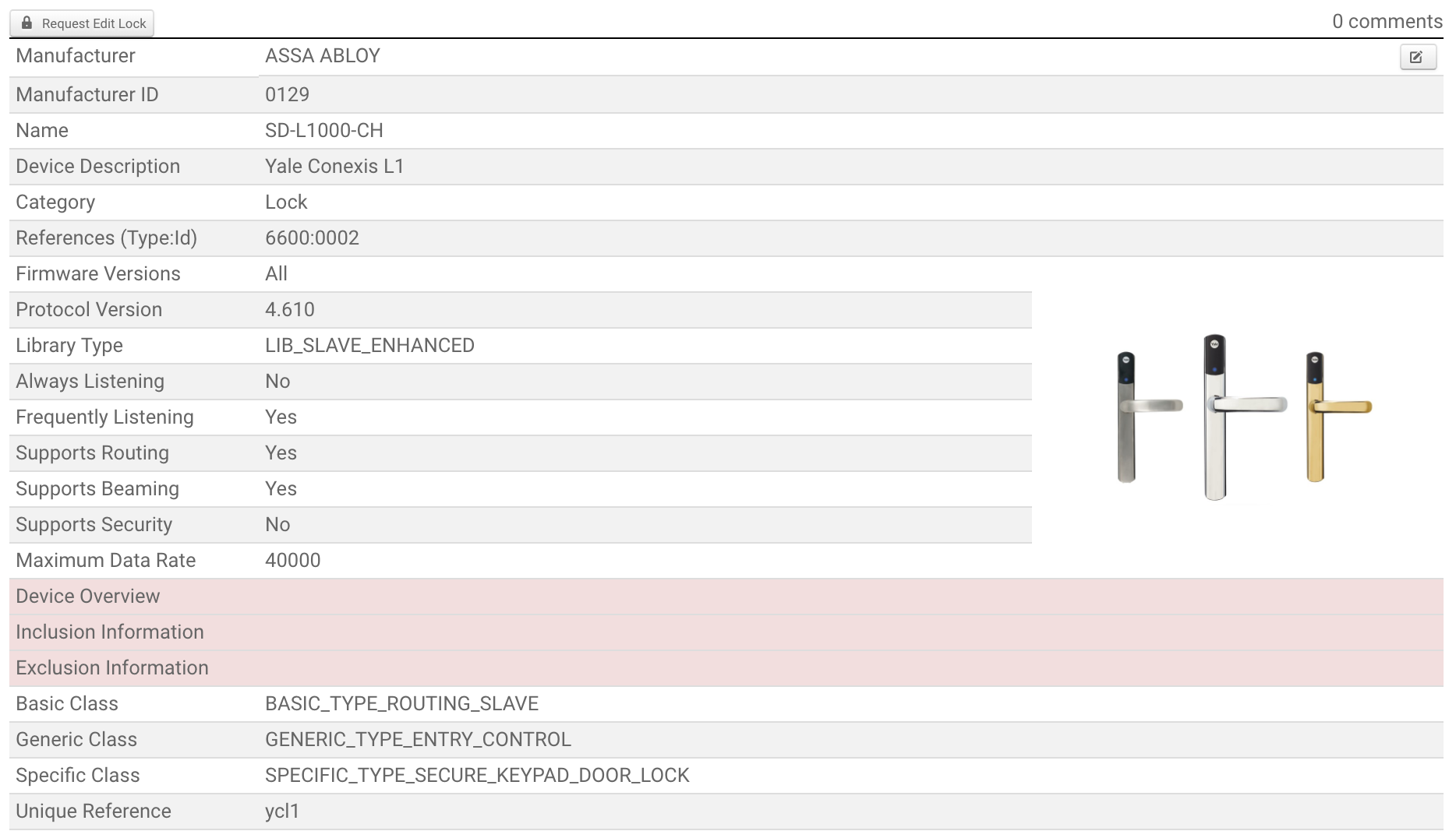

I tried the updated version of the binding today, but I still get ‘Unknown Device’ - it looks like the changes on SD-L1000-CH are not yet updated?
I apologise if I made a mistake with this one, I think I may have accidentally ‘edited’ (without changing anything) the ‘Yale Smart Door Lock Z-Wave Module’ in the process of creating the Conexis L1! Please do let me know if I’ve made any mistakes, or if you need me to get some info off the device.
@chris, do you think it would be possible to recompile the binding after approving the info in the DB for SD-L1000-CH?
I plan on doing an update tonight, but at the moment, you’ve not requested a review (which is why it wasn’t approved yet ) and I just checked and probably the reason you didn’t request review is because there are a bunch of errors -:
It looks like simple stuff - just updating the information in red below -:
If you can do that in the next few hours then I’ll get it in the binding tonight…
Hi @chris - sorry about that! I’ve included the additional info, and I’ve requested a review!
Thank you again for your help!
