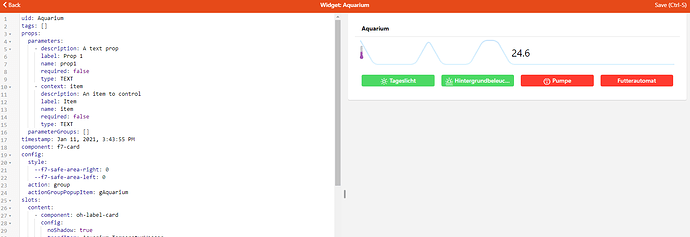

YAML for dummies, somewhere?
I’m playing around with custom widgets, copy&pasting code snippets from different posts without really understanding what I`m doing. I see there is some kind of structure inside a YAML file, like props, config, slots, content etc. and I’d like to understand the basics of those parts. I’m reverse engineering from preexisting widgets and configs found on the forum but still have no complete picture.
can someone point me to a tutorial or how-to to better understand the basics/structure of an OH yaml file?

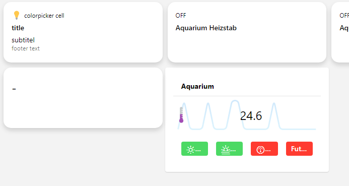

(eg. where’s the line under “Aquarium” coming from, why’s °C missing in the temperature curve and why does my custom card looks different to all others?..)

unfortunately your YAML lost all its indents - and with that the structure.
YAML, just like python is nesting through indents (whitespace before your line), other languages use brackets to mark a clear hierarchy.
Now I am still on the same path as you are, but think of it as defining a HTML/CSS Page. You set the type of your page (f7-card) for example and then you add elements on the page, like a header, a footer, and nest other components like e. g. chips/tags. These components go under “slots” and can be further nested.
So where is your °C: An item can have a separate displaState where it will give you a string with unit, depending on how you set up your item.

EDIT: FYI adding %.1f %unit% as pattern to the item solves the missing unit in the widget too…
