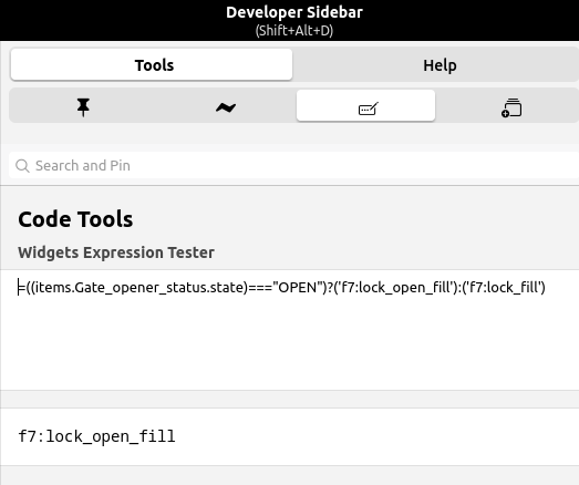

Why don’t you use the developer side bar?
It will show you what the result is for the item.
Make sure the equal sign doesn’t have any spaces before it in the panel as it won’t work. I have been stung by that before and wondered why it wasn’t working.
The example above shows that the gate status is open so the f7:lock_open_fill icon will be used.

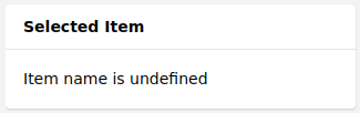

The expression tester does not have access to the same context as the widget editor. If you have selected test properties in the widget editor, those are not available in the tester. So if you have:
uid: demo
props:
  parameterGroups: []
  parameters:
    - name: item
      label: Item
      type: TEXT
      context: item
      description: An item to control
tags: []
component: f7-card
  title: Selected Item
  content: =`Item name is ${props.item}`
Before you select an item it will show that props.item is undefined:

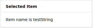

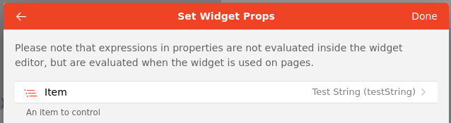

Then when you do set the props:
It now correctly shows that props.item is the name of the item you have selected
But, that props.item variable only exists in the context of that currently open widget editor. It does not extend to the widget expression tester:
This is the one weakness of the widget expression tester. You can’t use variables or properties in the widget tester, you have to put in the actual values you want to test.

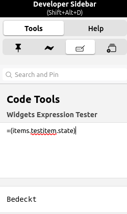

If you create a ECMA script and put below in as an example but change testitem to the name of your item that is a string that you want to compare with:
items.getItem("testitem").postUpdate("Bedeckt")
Then run that script and look at the developer sidebar you will see the result. I believe this is the bit you are missing.
Basically what you have to do is put the data you want to compare into the item.
