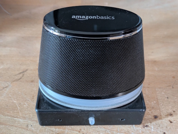

I wanted a few small units for speech-to-text (voice recognition) and text-to-speech (voice output) for my home automation environment, which includes openHAB and Rhasspy (details here).
Previously, I have used Rhasspy satellites built with a Raspberry Pi and a small speaker (described here), but now I wanted something simpler and more compact, and with the voice recognition happening in the satellite device itself, without streaming audio to a server, not even to an in-house server.
The solution was to package the ESP32-S3 module with a small speaker, and write software that uses the speech recognition library provided by Espressif, integrates with my existing home automation environment.
Key features are
  • low cost:a small device based on an ESP32-S3, total cost of materials ca. €20
  • privacy: self-contained speech recognition in the device, no audio streaming to a server
  • dynamic: automatic configuration for voice-controlled items defined in openHAB
Source code and schematics in Github, and more information in my blog.
