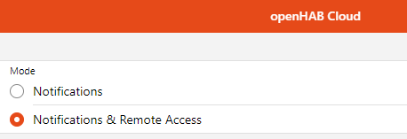

  • Myopenhab.org cloud must be connected and set to notification and remote access - items don’t need to be exposed explicitly
