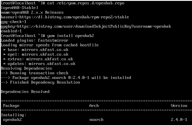

Hi @BiloxiGeek,
I couldn’t replicate this problem, could you check that you have the same settings as I do?
@Benjy
My openhab.repo file looks identical, I have the snapshot and testing repos listed but not enabled.
