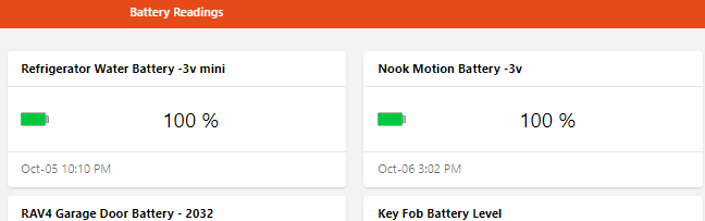

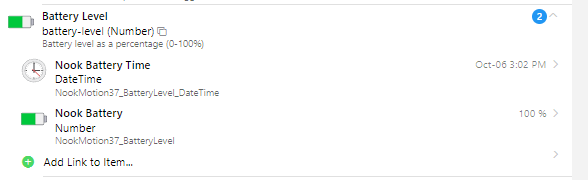

What I have set up (and there are other ways to do this) is to link a date-time item (timestamp on update) to the battery channel and then have a page with the batteries % and date so I know the reading (100%) is recent;

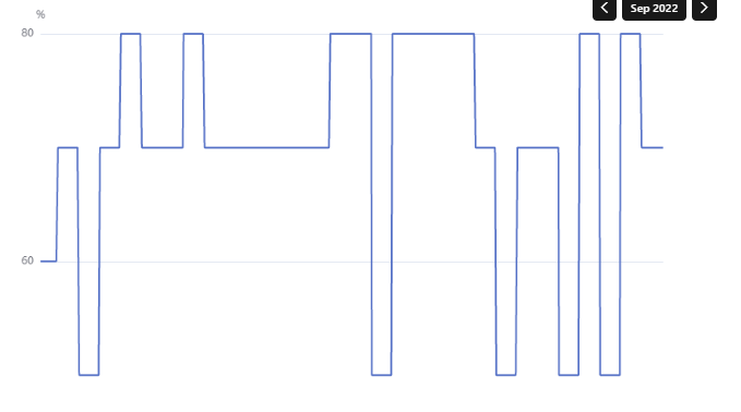

I’ll defer to your expertise, but I do see Li-ion batteries provide power (maybe the device voltage calculation is not precise to show a capacity decline?) until they suddenly don’t. On the other hand my alkaline device (3xAA) is all over the map. This is reported by the device in September on a single set of alkaline batteries.
